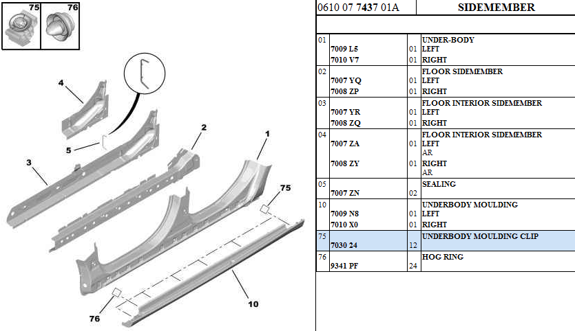

Does anyone know what sort of clips hold the sill covers on please? The car's an '09 Exclusive Tourer - at some point, the rear of the cover has had an impact of some sort, which seems to have 'sprained' the plastic a bit, causing it to spring off whatever holds it in place. Banging it back into place results in it staying on for a bit, but then popping off again. Annoying! :evil: I was thinking of taking the cover off completely to see if the slightly distorted bit at the rear end of it can be bent back into shape, but am thinking also that I'm bound to break some clips! :-D

These Pete?

Re: C5 sill cover clips?
I think anyone who owns a C5 X7 ought to invest in a pack of those clips - p/n 9341PF - as they seem to hold on most of the various bits of plastic fitted all over the cars :lol:

GiveMeABreak wrote: 26 Oct 2017, 20:12 These Pete?
Click to Zoom
That's the ones! Thanks Marc. =D>
