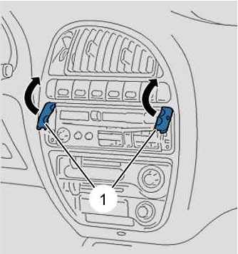

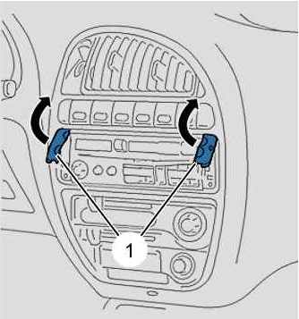

Does this look similar to yours, Jim ?
saxo radio removal
saxo radio removal
Slide the bits at 1 up and out.

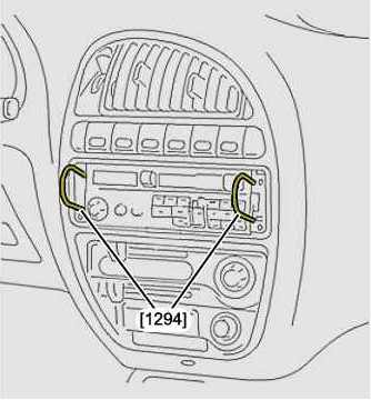

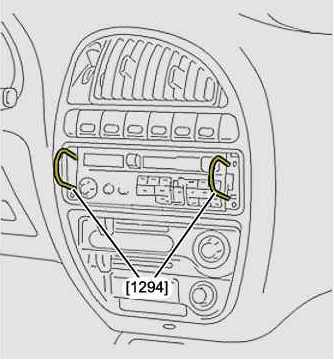

saxo radio removal 2

Yes, but we could not get the bottom latches to disengage.

The destructions merely state......
"The side fascia elements (1) (as per arrows)
The upper part of the fascia elements (1) by pulling towards oneself"

You have to ensure that all four of the lugs / release pins are fully disengaged when pushing the radio release keys in. Just one stuck will cause a problem.

I think I know the problem now... My removal tool is a little too narrow and both 'tines' were not going in at perfect right-angles :)
I shall 'modify' them and try again..
