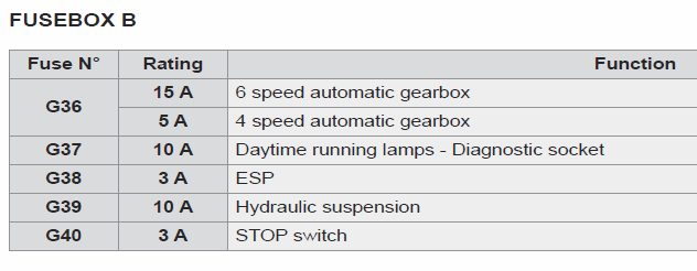

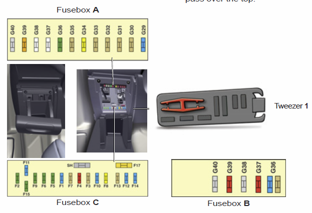

Can I presume you are aware the hydraulic pump also is fused on fusebox B in the glovebox yes, there are three boxes here, the obvious one you see when you remove the cover and then two fuse boards above you have to lie in the footwell to really see. I'd give you the fuse number G37 but citroen do not mark them on the box. The fuse you need is on the right hand (vertical) fuse box (they are top to bottom 10A, 3A, 10A, 3A. The hydraulic pump is the top 10A fuse.

G37 is actually for the daytime running lamps on some models - G39 is for the Hydraulic suspension Mike
The location below is shown in the stowage drawer on a left hand Drive, but for a right hand drive will be in the passenger glovebox compartment. Fuse box B is to the right - just inside the recess
