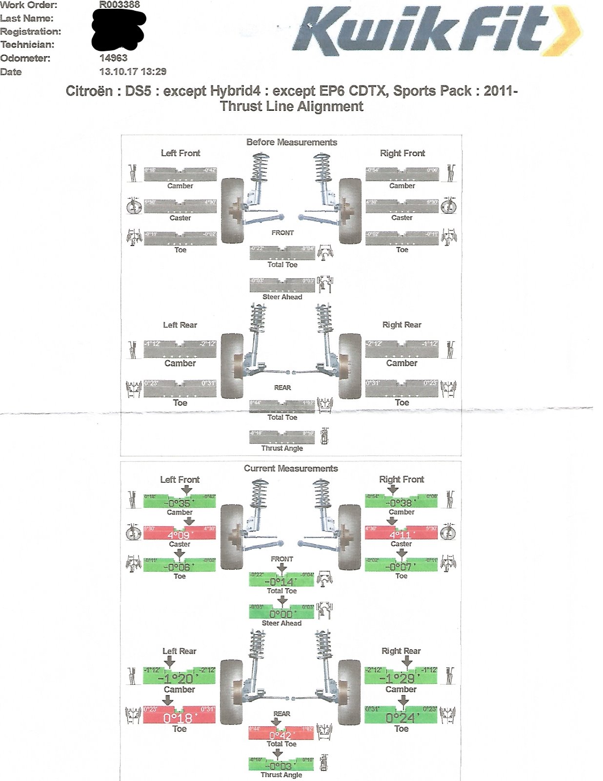

All was well until I realised the car was pulling to the left so took it to Kwikfit for an alignment check. Front was near perfect but the left rear wheel was showing a toe of 0 degrees 18' to the left, putting it in the red giving a total rear toe of 0 degrees 42' to the left, again putting it in the red. The rear right wheel was within tolerance. They said they could not adjust it as the rear suspension is non-adjustable. Fair enough.

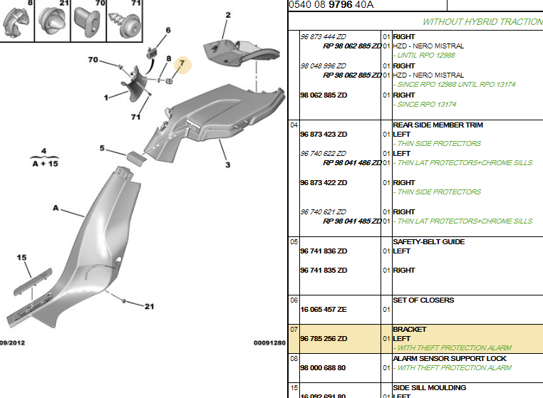

I noticed today, or rather a nosey work colleague did, that there was only one alarm sensor in the rear of the car. There is one on the left side rear pillar(?) just behind the rear door in the same panel as the curtain airbag, but not one on the right hand pillar. Nor is there a hole for where there should be one (ie it hasn't come away, been knocked off, etc) which is leading me to the conclusion that the sensor has not been re-instated during a repair after the airbag has deployed. The alarm bells are now klaxons!

1. Car pulls to the left
2. Rear tracking is out, left and right

4. Left rear curtain airbag cover has an alarm sensor, the right side does not.

Donkey wrote: 21 Oct 2017, 02:53
I've confirmed from doing some research from another 180 - there is only an alarm sensor fitted to the left of the vehicle - not the right.
The parts list below (7) & (8) show only the bracket and support for a left side sensor - nothing for the right, also confirmed by checking the wiring harness for the sensor - only goes to the left. So looks like Citroen have cut a few costs / decided it was not necessary to provide another one.
(Click to zoom the picture)

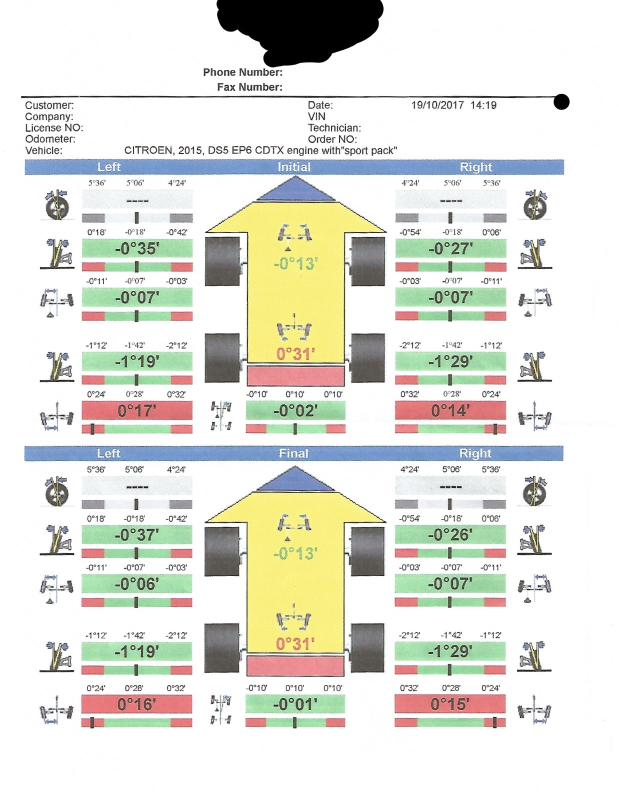

These are the alignment printouts. First one is from Kwikfit, second is from the dealer. I'll admit I don't really know what I'm looking at here. But I'm sure there should be nothing in the red!
First Alignment Check: Kwikfit

Second Alignment Check: Dealer

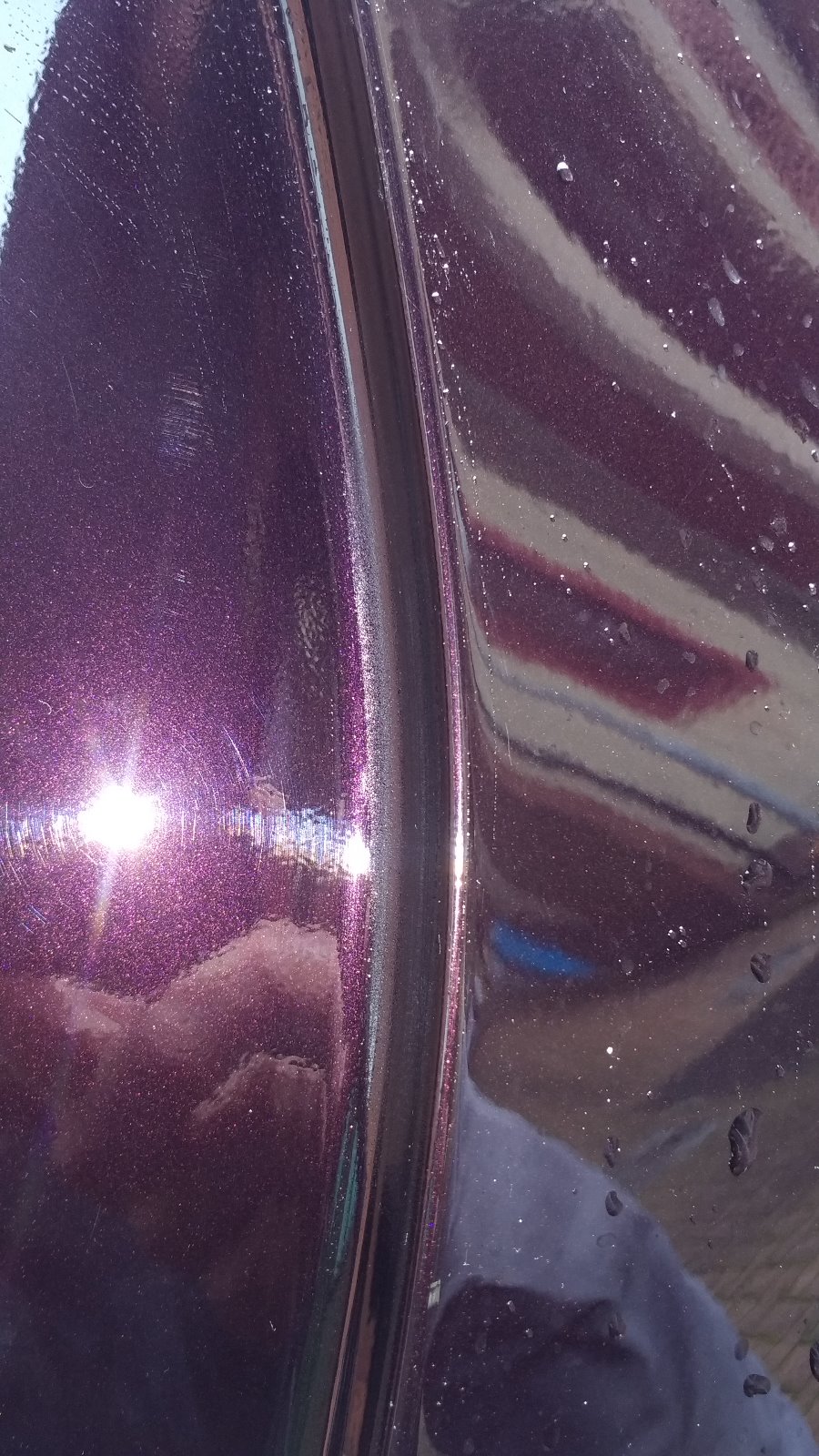

I've had a closer look at the body work and have found an unfinished rough mark a few inches long near to the door catch on the rear pillar. It's not at a point where any of the rubber seals make contact so it's not caused by wearing. It feels rough, too. A defect from manufacture perhaps?
Anyway, couldn't get RAC to do a check so went with a Comprehensive inspection from AA. Hope to get it done during the next week.

Is that rough finish on the same side that the window glass was replaced? If so, it could well be from a recent bodyshop repair job. Hopefully if you get an inspection they should be able to spot any structural repairs - and if that is the case - then more reason to reject it. More importantly, either the dealer did not disclose the damage or was not aware of it - but the previous owner (s) would of been and have not disclosed it - either case your deal was with the dealer not the previous owner. If it has sustained some structural damage and been repaired and resprayed without your knowledge then who knows what you have bought?
