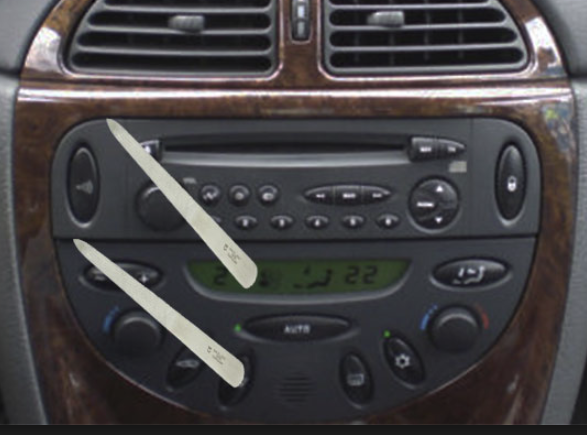

faddy wrote: 21 Oct 2017, 13:22 The radio's been silent for all of the few months that I've owned the car, so I don't know whether it deteriorated or failed suddenly. How easy is it to remove the head unit?
Quite easy - I had mine out a while back.
Use a thin-bladed but blunt knife or spatula to release the two trim sections around the buttons either side of the unit then there are (IIRC) four cross head or torx screws holding it in.
- x 6950
Re: C5 silent radio
Here's a picture to illustrate what Steve mentioned above:
