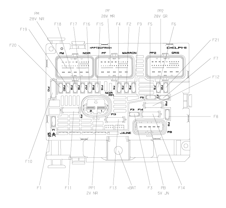

If your OBD scanner is also not communicating, then I would check all the fuses systematically in the passenger glovebox compartment (there's a top row too) and in the engine bay fuse box too as I mentioned. If there is nothing obvious there, then I would begin suspecting the engine fuse box or the BSI. Others have found a loose / dirty connector can be the culprit, especially if disturbed. I would suggest a Lexia - but as you cannot get any communication with your scanner, it is unlikely that a Lexia will work either if there is no power / communication.
I've had a quick look at the fuses for the Diagnostic socket - F7 in the engine compartment fuse box behind the battery:

Hi iv just checked battery witch was fine all fuses with a tester and found a 3 amp fuse under dash was not working but looked fine changed it and all the dash has came back on but still no obd and car is still cutting out
