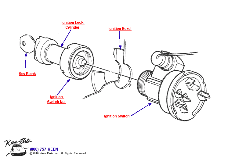

I doubt it as the actual switch is most probably separate to the lock section.
as here:
as here:
