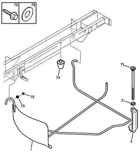

I need help understanding how to remove the spare tyre storage apparatus- the long securing bolt plus the metal carry rod that takes the weight of the tyre.
I need help on how to safely remove both of these - as I do not want to damage them. I will put them back on when I sell the car.

There's not a lot of info on how to remove the wheel carrier. It looks a very simple bit of equipment.
Undo the bolt, drop the carrier, remove the wheel, unclip the carrier - one side will probably unclip easier than the other.

I need help understanding how to remove bolt 71 in the picture - it seems to have a stop to prevent it's complete removal - in case the use over does it.
I am pretty sure that it's not just a case of unscrewing till it is released.
I don't want to force it as I'm sure there's some sort of 'stop' that I could break - or the bolt might shear off.
Can anybody take a look at one - or give me an idea of how to do this right?

Similar bolt on XM wheel carrier. If it is unscrewed all the way, the threaded 'hook' will actually fall off. Possible that on later cars the last couple of threads have been peened/clipped to prevent that. Try a bit of brute force: you won't shear the bolt . . . especially with its daft semi-circular slot at the top, to which I welded a nut, so that a wheelbrace/socket would fit it.

If it's the same as the one on my 306, which I removed when I was applying the underbody wax the carrier just unhooks.
The bolt can just be withdrawn once the "hook" has been unscrewed from the end.

Update:
Will be hoping to remove the cage this weekend.
Will lube the bolt shaft for an hour with wd 40 before hand and see if it will simply twist off.
Will update with results.
