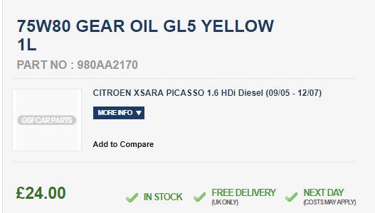

GSF - Once reg has been inputted - stock this.
Can you tell me if there are any issues with this - or - whats the right way to ensure I get the absolutely correct transmission oil for this particular car?
Appreciate any input you can give me today as gsf have 56% of all orders till midnight tonight - with promo code WKD56

Real need to check whether correct spec for the car is GL4 or GL5.
The two are not interchangeable, and 5 is not a replacement for 4.
My guess is that you should be using GL4, which is pretty well universal for recent Citroens.

Do you have the owners handbook for the Picasso? If you do, it is likely that it will have details of what oils to be used, including that for the gearbox.
The easiest way is to post up or PM your VIN so one of us can check. The reason for the need for a VIN is some of us have access to the Citroen electronic workshop manual - we enter in the VIN and it comes back with everything needed to know about the car - from how to change a lamp, replace a clutch, calibrate whatever needs calibrating, etc, etc. Part of the info returned is what spec and quantity of lubricants are required for the car. The other handy feature is a complete run-down of what your car left the factory wearing i.e. optional extras, specs of components, etc, etc.
Various bods on this forum have provided this service for years - have a look on the 'VIN Decoder' thread to see !
For info, the spec for Total BV 75W80 is it's a GL4+ that meets PSA spec B71 2330
