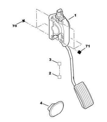

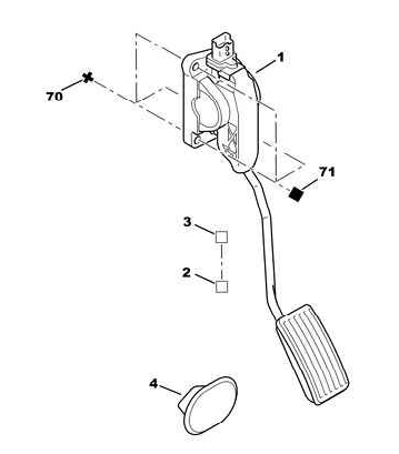

But with the other 2 faults - I'm wondering if your accelerator pedal is duff and could be sending incorrect data.
1601 Q4 (Left Hand Drive) - but I'd need your VIN to double check, is the one with the speed regulator
A failed sensor can be the cause of poor fuel economy - have a quick look here that explains it:

1601Q4 is the one, according to service.citroen.com.
But, the fault code states that it's the speed limiter switch that's malfunctioning. Do you think that can cause my problems?

When driving the gas pedal % seems to be reasonable.

I shouldn’t of said that this is the right part for the C5 with speed regulation fitted. The reason I suggested this is because it had a ’kick down’ zone, on the accelerator pedal that overrides the speed limit setting in an emergency when you may need to overtake quickly. That along with the poor fuel economy as per the article I linked to. The other cruise control faults can be linked to a faulty break switch.
