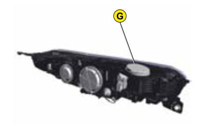

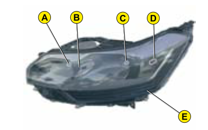

If Sidelight (shown as 'B' below) and you have the Halogen lamps (not the Xenons), then all you do is lift the 2 pegs up out of the headlamp covers, then pull the clip vertically at the corner of the cover to remove.
Once you have that off, just pull off cover G as per the picture and extract and replace bulb. It's a W5W.
If it's the DRLs, these will on earlier models be the HP24W and are accessed from underneath the headlamp - which although they can be done with a lot of patience and twiglet fingers, some have found it easier to partially remove the bumper for the first time, until the bulb holders can be released and greased for next time. Anyway if the car is pre DRL legislation (EU cars approved prior to 07/02/2011) then DRLs are not required for the the test as they were not a requirement before then.

Hi Marc and thanks for your reply. I'm told that the problem is with the bulbs shown as E in your picture. Looking at the lights just now, these bulbs aren't the only ones that have gone! They don't last long, do they?

Well those are the DRLs. Unless you wan them working (you can deactivate them from the car's menu), I wouldn't worry as they are not a legal requirement for DRLs on your year C5 - they have just been activated, like many of us here do for additional safety. If you need to know how to deactivate them, just shout. A lot of us have replaced the DRLs with LEDs - although it is a fiddly job, as the replacement bulbs are about £40 each excluding fitting.
