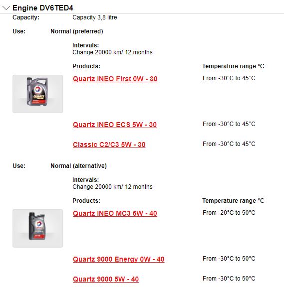

I suspected that since all the oils recommended for the DV6TED4 engines are Total Oils - I should visit the Total website and this was the result:
Recommended:
I am not too worried about the cost. I want to get the oil that will have the best effect on the engine for the 12months it's in there - given the engines age/milage.
I am travelling from interview to interview, and will have no other means of travelling - if the car konks out on me.
It has started producing white smoke from time to time - it hesitates from cold start - and is exhausting a foul smell.
I'm hoping a service will get me by until I clinch a job in the next few weeks.
I would really appreciate it if you could help me choose an oil that will give me the best chance of keeping her ticking along for the moment.
Recommended:
There are too many here for me to choose from - to know whats best.

5 w30 in the UK, and half the recommended change intervals to preserve the turbo.

Unless it's been superceded, INEO ECS is the one for these engines. Others are ok in a pinch. Best to go for 10,000mile oil changes as a minimum.

5W-30 is best for this climate, I'm told. Therefore the Quartz INEO ECS 5W-30 is the preferred option.

In my handbook (printed and up to date when car was new 2005) they recommend an older 5w-30 Total oil. Since then, the newer ECS was developed (and probaly ones before that) and is the most current that meets the demands of this engine AFAIK. I don't know the exact specifications to go for but low-ash (saps) is required for DPF-equipped engines and the ECS is the best I know of.Andle wrote: 19 Sep 2017, 19:52MikeT wrote: 19 Sep 2017, 19:42 Unless it's been superceded, INEO ECS is the one for these engines. Others are ok in a pinch. Best to go for 10,000mile oil changes as a minimum.

Agree.....No 2 in the list.
