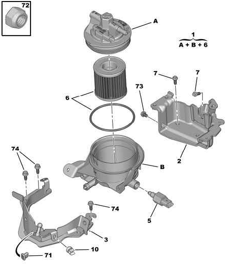

There would appear to be an electrical connector on the diesel fuel filter on the Mark I 110 HDi - part 4:
@ danny_C5 - Perhaps if you posted up your VIN, we can ascertain the correct model.

The picture above is the same fuel filter hosing as the one on my c5 and it was water in diesel error message that come up when the car cut out and died.

Ok, so you have a C5 MK II Saloon 2.0 HDi 138 with particle emission filter and manual 6 sped gearbox.
Here is the diagram showing the assembly. Part 5 is the actual water in diesel sensor (PSA Part Number: 1913 11). It is important that the circuit is primed after changing the filter - this may be what is causing some of your problems.
To that end, I've emailed you the correct procedure for priming the system after changing the fuel filter.
