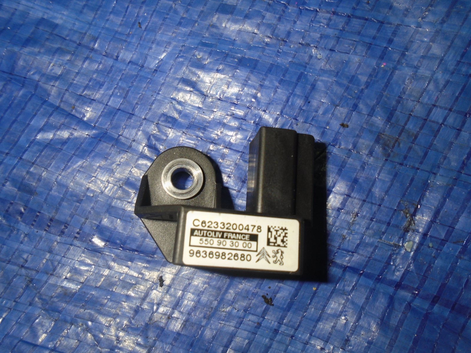

Re: Side airbag light won't go away
johnny625 wrote: 17 Sep 2017, 21:53
Now do MK1 Xsara's have a separate side airbag ecu also. If so where it is located?
Just to answer that question, it depends on the age, the early models had a separate ECU for each lateral airbag, it was a metal casing & just looks like a half sized normal airbag ECU, the airbag was connected directly to it & it also detected the impact, this ECU detonated the airbag directly. It was bolted to the inner sill near the B pillar.
I would imagine being a 98 model this is the setup you would have.
Later models had a single central airbag ECU & all the airbags are directly connected to it, In the inner sills there are basically just little impact sensors known as satellites which are connected to the central airbag ECU.
Something like this
