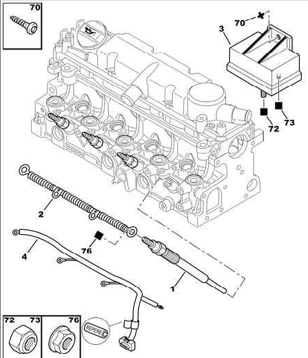

Re: STUMPED!!!white electrical smelling smoke from rear of engine bay
So yours has a Glow Plug pre-heating box (item 3) in case that helps identify the part Darren:

The above item 3 looks like the relay to control the engine glow plugs, so I doubt it has the water heater if that's the closest Marc could find.
Just out of interest, how long have you run the car for? If not long, and you don't find anything obviously melting on the exhaust then it may just be assorted muck from reassembly burning off.

maybe so, yes that's the glow plug pre-heater relay it lives under the injection ECU I can't see anything that would preheat at the back of the engine, thanks lads I couldn't see anything, but visibility is poor it could be something on the manifold itself I suppose which is hiding under the EGR assembly.
