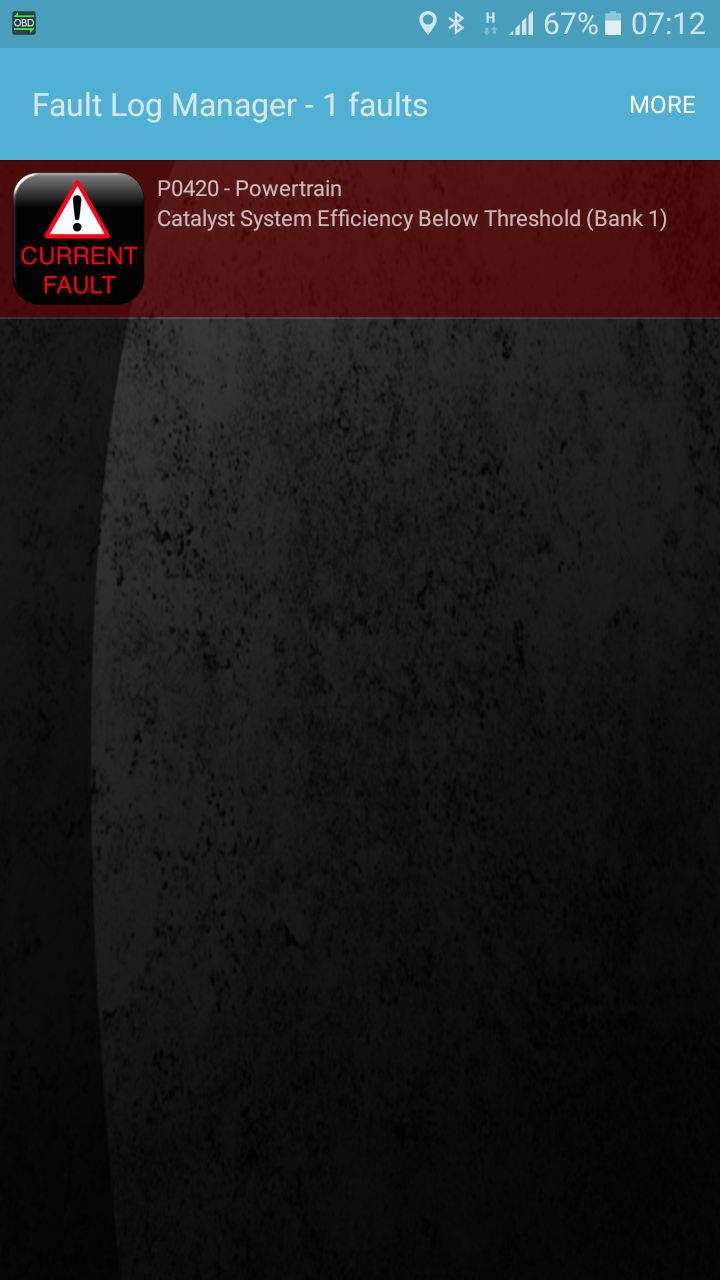

Code
- x 6950
Re: Code
The error code will be related to one of the oxygen sensors. If they are working correctly, then it may indicate that your Catalytic Converter needs cleaning or replacing. Catalytic converters can trigger the engine management light (via the sensor readings) even if they are 90% unblocked.
