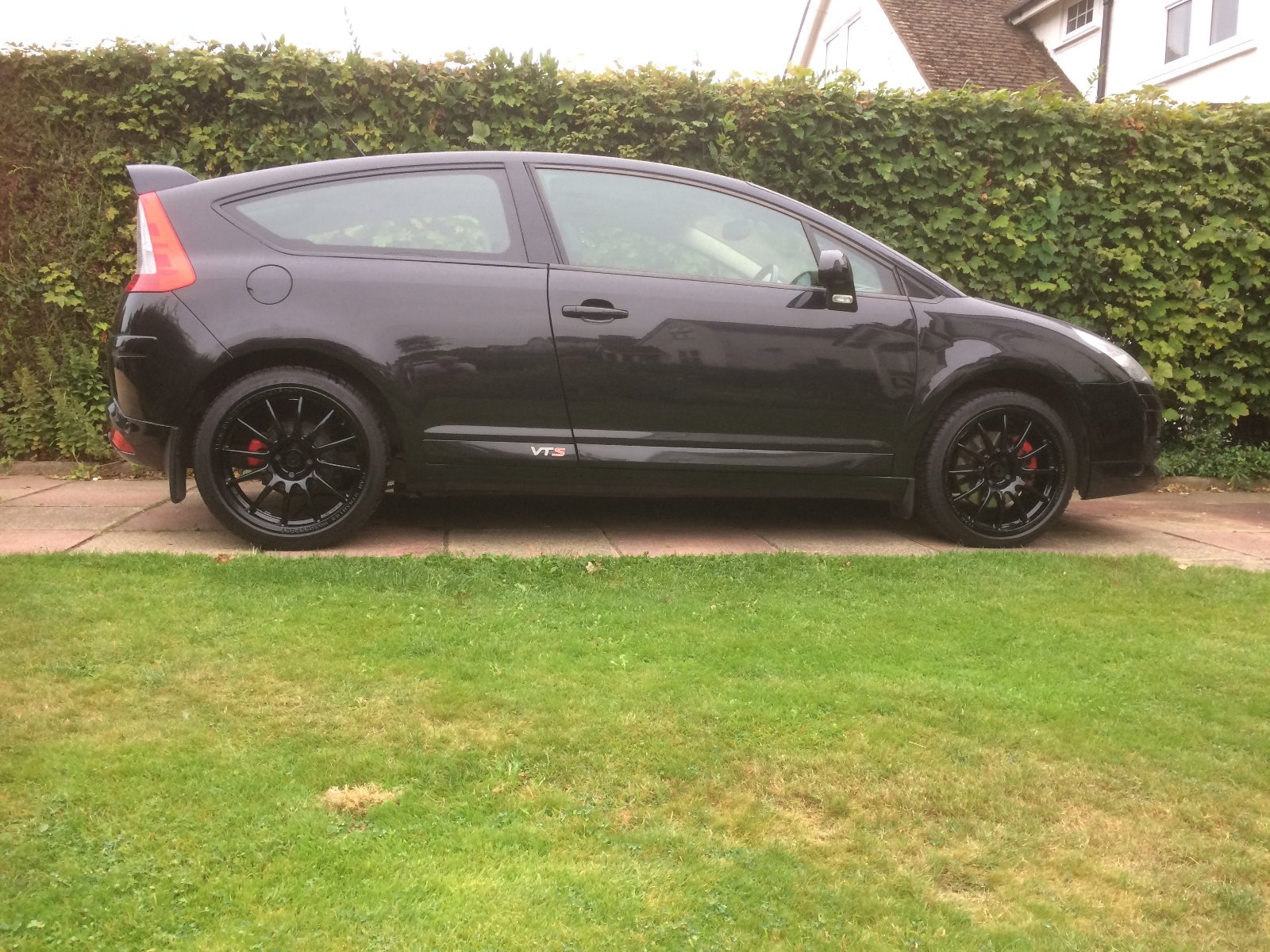

What colour and spec is your VTS? This is mine
https://www.frenchcarforum.co.uk/forum/ ... &start=195
