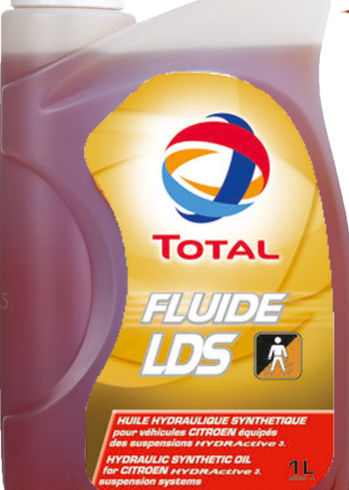

LDS fluid is thin and red(ish)

Hi Bobins,
thanks for the reply. The stuff in the reservoir is a deep cherry red rather than the rich honey like amber colour of the LDS. The oil thats in the car at the moment is a lot darker and thiner than the oil I obtained from the Citroen dealership to top up the reservoir when it was leaking.
It was the stark colour difference from what was in it before that made me think they had placed in regular steering fluid rather than the LDS/FDA
