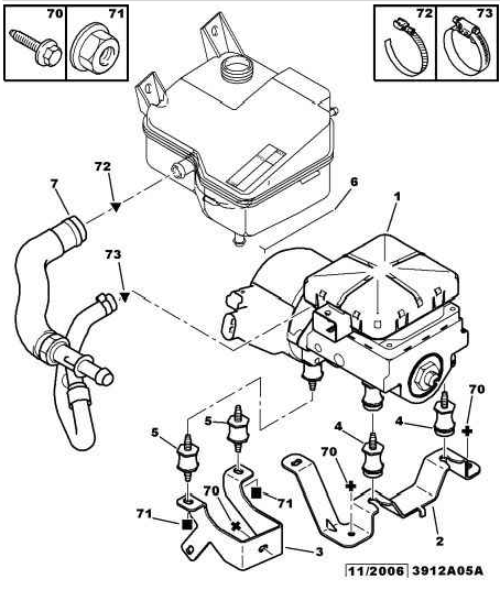

seanrx
- Posts: 168
- Joined: 02 Feb 2017, 12:11
- x 6
Re: Sus pumps. Diesel for petrol.
Ta for all your replies and 16 different types?
Right now, a motor clean is my only quick option.
I now have the arch liner off. And to be sure, its the pump only, that I see in there hanging next to washer unit and that the motor is under the LDS tank?
They are joined only by the fluid hose that passes through the chassis wing?
Right now, its the motor only that I want to clean.
Thanks Marc, but right now I just need a quick answer to my last post.
Am here spanners in hand.
Motor is under LDS tank and pump is separate on the wing?
- x 6945
No, the BHI is a complete unit from the diagram: This is for a Mark I C5, as I don't have your VIN - Click to zoom:
The LDS reservoir tank is separate and connected by the hoses - yes as far as I can see.
That's good to see. I've just emptied the LDS.
So its only the lump in the wing thats coming out.
