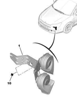

How do I get to the horn as it looks hidden front left side near light somwhere I believe.
Onlinemyglaren
- Posts: 28622
- x 5634
Re: Weird Electrical problems - New Owner C5 X7
Couldn't say with the X7 but mine is behind the front bumper on the nearside.
