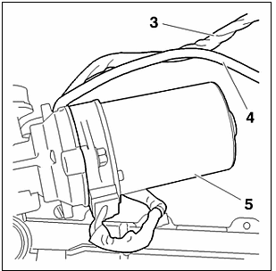

Your Power Steering system on the TU3JP engine consists of an electric motor and torque sensor:
(3) Electric assistance motor supply.
(4) Signals from the torque sensor.
The power delivered to the electric assistance motor ( 5) depends on the following elements :
Vehicle speed &Torque applied to the steering wheel.

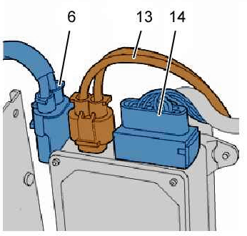

The electric power steering ECU is located behind the battery tray (regardless of engine type):
The electric power steering ECU is linked to the following connectors :
(6) Electric assistance motor supply Electric motor harness
(13) Electric power steering ECU supply
(14) Torque sensor signals and diagnostic information
So these are the connections you can check first. If you have checked the obvious, and have access to a lexia, there are some parameters that can be measured to aid in determining the problem, such as:

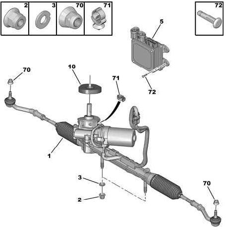

Sorry to necro n old thread, but I was wondering if it's possible to obrain a replacement for the sensor without buying a full rack assembly, and or if it is possible to re-calibrate/zero the sensor?GiveMeABreak wrote: 04 Sep 2017, 15:12 Your Power Steering system on the TU3JP engine consists of an electric motor and torque sensor:

This is a different system to what you have on the X7 - the above was specifically for the C3 which has a completely different Power Steering system Jay.
