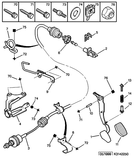

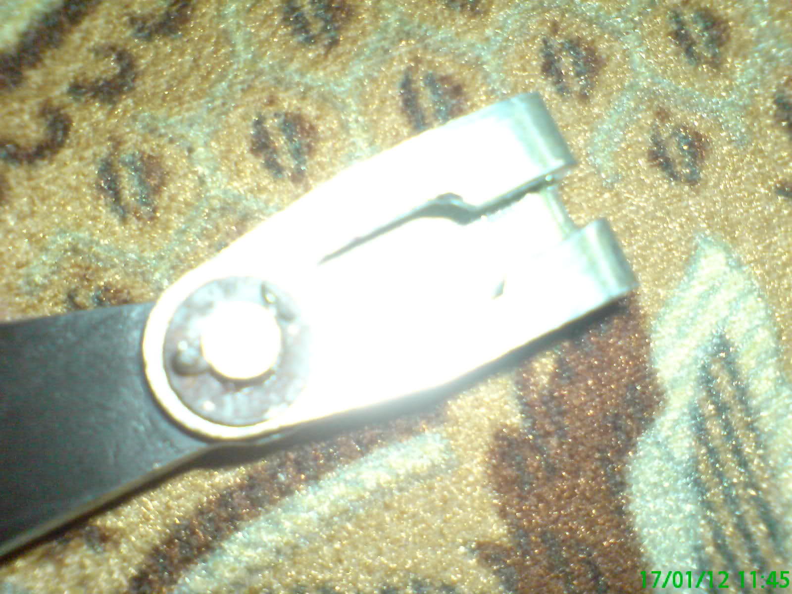

It has happend to my xantia and I made an adaptation with a metal bracket. I don't think you have to change the clutch.
The plastic receptacle is piece number 2.
The metal bracket is working from 6 years without a problem.

Hi xf1ref, any chance you couple give some more details about your adaptation? Is your photo showing the metal bracket attached to the top of the pedal, thereby replacing piece number 2 in the diagram? (In which case, does this also do away with the need for piece number 5?)
What did you use to make the bracket, and how does the cable fit into it?
Sorry for so many (dumb?) questions, but the garage say we're looking at a circa £600 quid job to replace clutch which, other than a slightly heavy pedal, performs all the expected clutch functions perfectly. Your solution looks extremely sensible to me! Add to that the fact it's worked flawlessly for 6 years...brilliant...!!!!

The metal bracket replace the piece number 2 and number 5. The bracket is U shape and is attached to the clutch pedal with a metal rivet. The end of the clutch cable is fixed inside the bracket through the cutting in shape of keyhole.
I bought the bracket, it was made for another car and I modified it a little...but I don't remember what I modified...I think I drilled a bigger hole in the pedal to insert the rivet
I found something similar on below link, the difference is the cutting where you attach the cable end.
http://yambits.co.uk/xt500-clutch-clevi ... 21154.html
