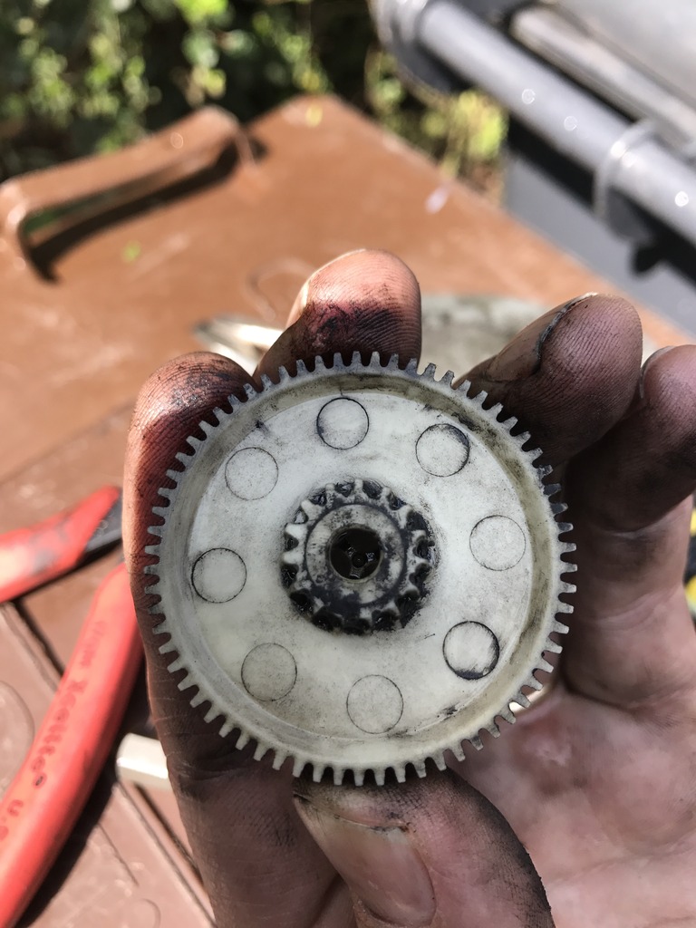

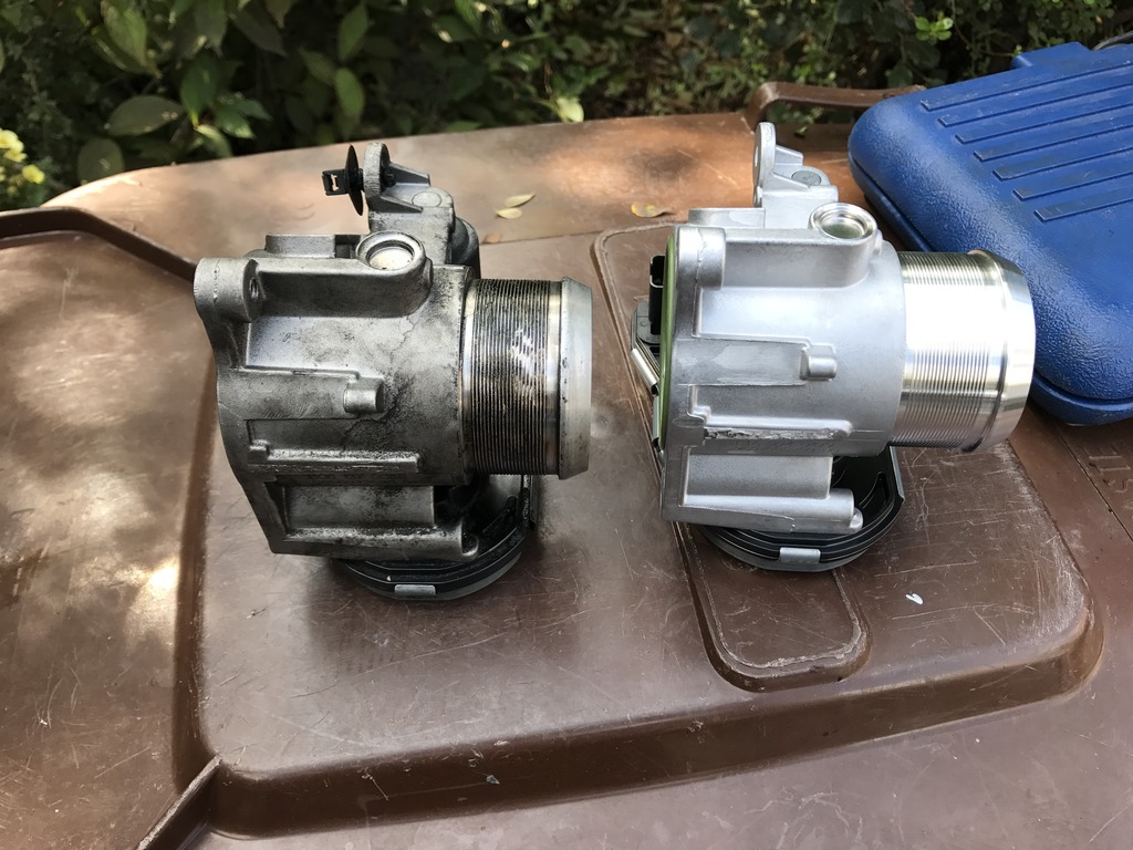

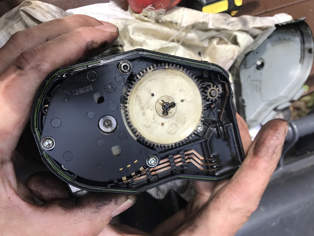

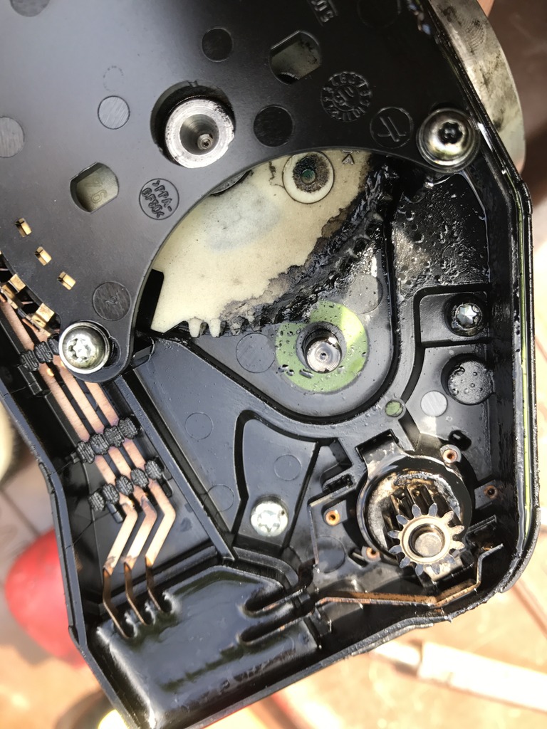

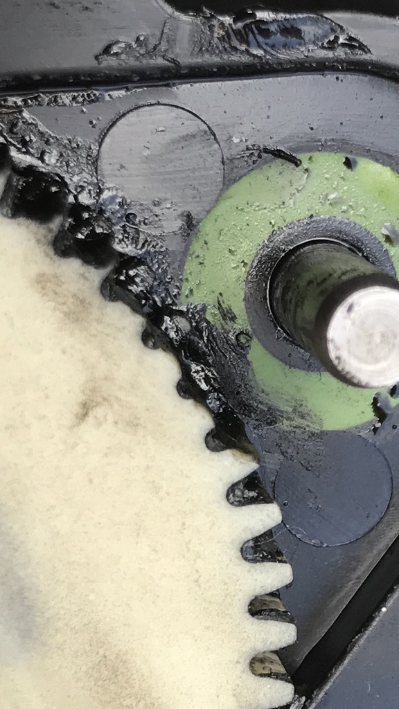

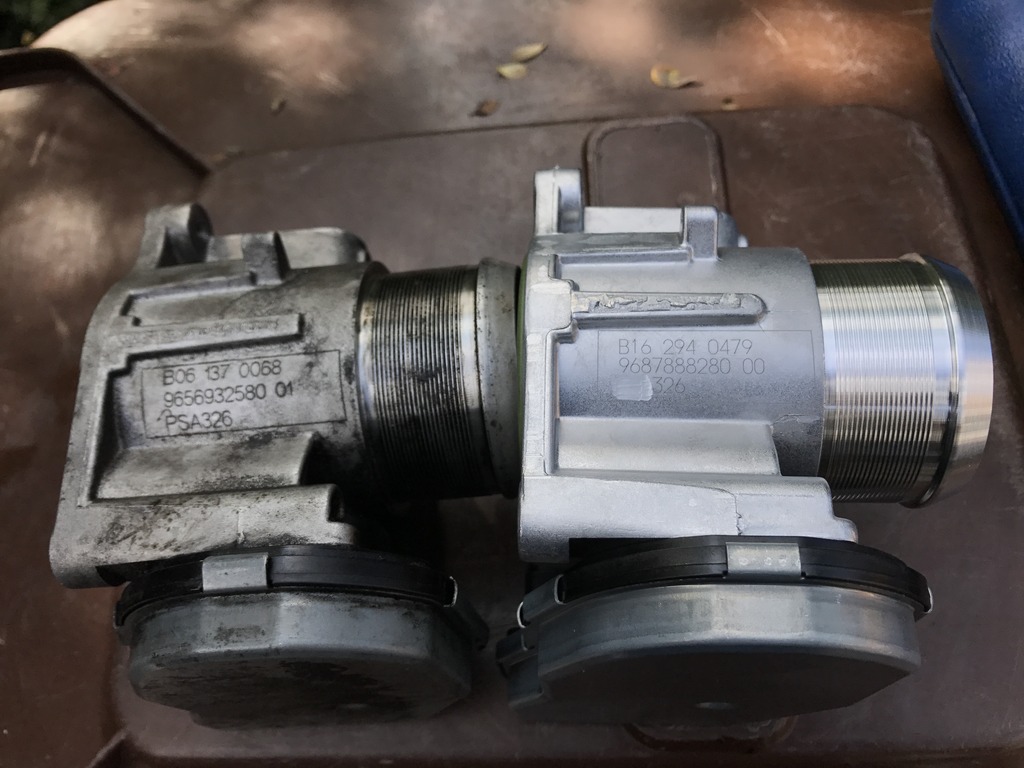

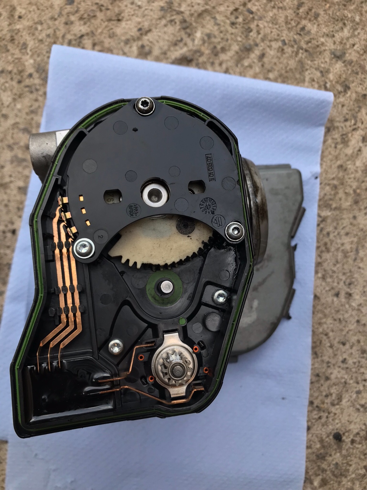

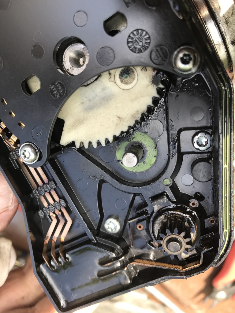

Thanks Richard, apologies about the slow reply but work has been a bit busy! I had a look on servicebox and found the price on there as you said at £221, too expensive for my liking!
So yesterday we took it off the car and took it apart to investigate, unfortunately a plastic cog inside had stripped. The throttle body wasn't particularly stiff, but I guess 10 year old plastic + a slightly stiff throttle body tipped it over the edge.
I couldn't find the part listed for my C5 from euro car parts for some reason, however when I put in a 2007 2.2 Mondeo which has the same engine, sure enough the throttle body popped up. Along with a 36% discount code I managed to get it for £109, and collected it within 20 minutes. Bargain! (in comparison to citroen prices anyway) Strangely enough on the throttle body itself there is a PSA code which is half rubbed off on the new throttle body, just to remove the PSA bit weirdly.
And finally... The noises the car SHOULD make.
Thanks for looking.

That's a completely different noise than was expected as per your other thread - having a video always helps identify the sounds, and had we had that, we would of been able to say that this wasn't a normal noise made when the car shuts down. Anyway, as you've tracked it down, here is the info you need:
Pop up your VIN and I'll confirm the part number, but if the 175 version, then it is part number: 0345F7. Current price from Citroen is £263.09 inc. VAT

Just like Dommo’s my gear was stripped. I just had a vague hope that I might be able to replace a gear to an unworn area - I’ve had luck like this a couple of times in the past and it’s a common practice on wiper wheel boxes on old British cars - but it was not to be
