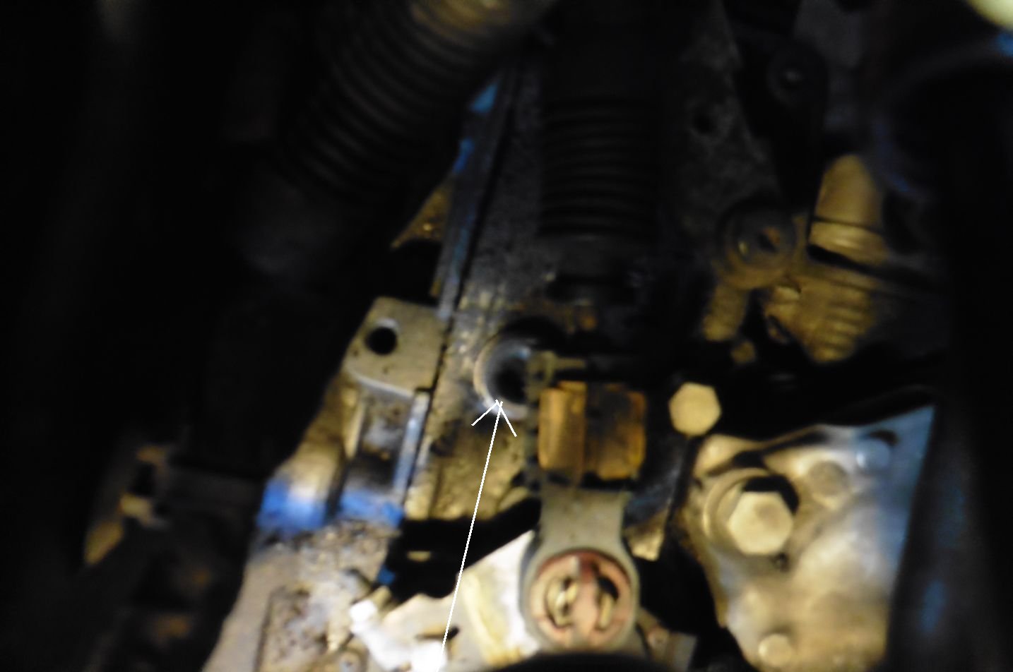

I decided to check the auto box fluid level, but instead of getting underneath followed a posting online that suggested looking in the filler to see if the level was over a grid inside.
This I did and as there was no sign of the oil I purchased a litre and put it in.
The level still did not appear above the grid, we used the car and all was fine.

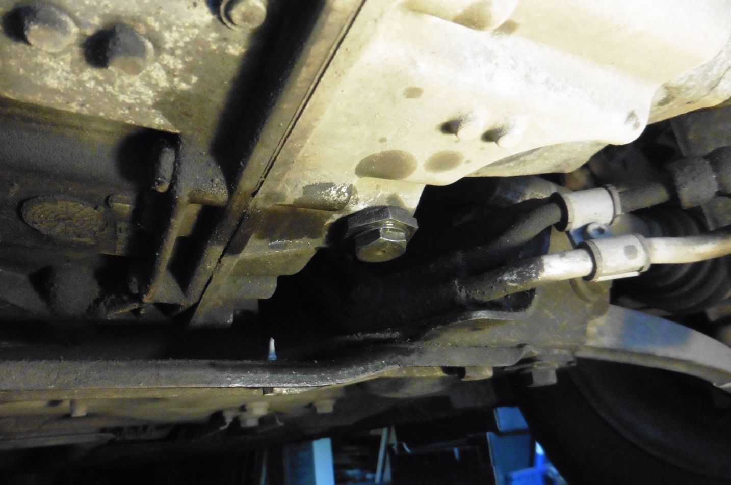

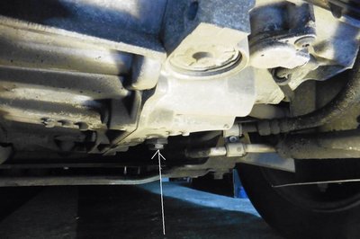

Today I drove the car a couple of miles then removed the bottom cover and undid the level plug the one inside the drain plug.

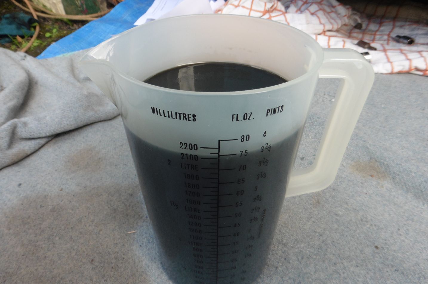

Two litters poured out, it then slowed to a trickle suggesting that it was now at the correct level.
I assume my litre plus a litre that someone else had over filled it with.
Hoped for the best drove the car, a bit of a jump presumably as the levels reset then several miles all ok.
I rechecked the level and the fluid just tricked out as it should.
The fluid is very dark, it smells a little like the new scuff I put in but more like oil.
That is about it, I drove it a few miles again all working fine, the car has done 155000 so perhaps the colour of the fluid is not surprising.

I would definitely keep flushing the fluid out until it is back to the right colour. Old fluid can kill auto boxes. Also make sure you use only the correct oil for that box.
