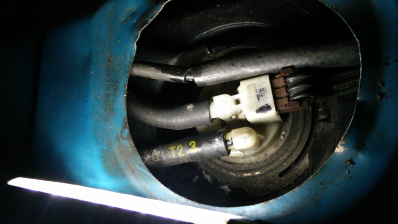

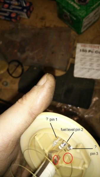

Hi, I have a AX 10E still at home and just upgraded the fuel tank to a 43L I was wondering If I could get the low fuel light working?
My fuel sender is off a diesel car so still working in a carb car.
I have three wires in the fuel sender
1 2 3
I know 2 is for the fuel level
1 and 3 seems to be linked on each other?

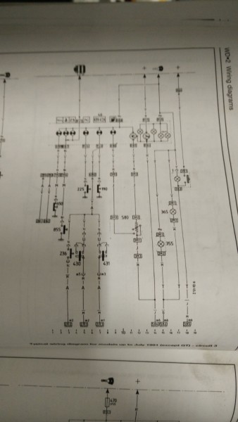

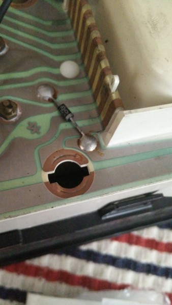

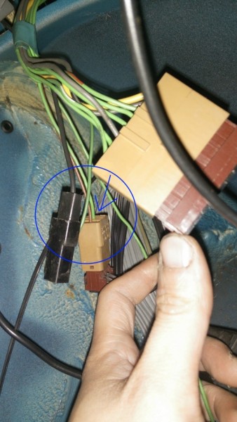

Sorted see pictures my loom is missing one wire under the instrument cluster.
Also need to connect another wire here since its missing wires as I have a basic model.
