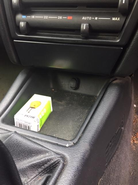

2) There behind the now spare indicator bulb (photo below) is a switch. It does not appear to do anything. There's nothing in the manual about it. I couldn't find a photo showing it or a mention of it anywhere online.
Mystery: WTH is it for? Is it stock or done after?

Kaibeezy wrote: 15 Aug 2017, 11:08 2) There behind the now spare indicator bulb (photo below) is a switch. It does not appear to do anything. There's nothing in the manual about it. I couldn't find a photo showing it or a mention of it anywhere online.
Not stock and certainly done after...
Only way to see what it might once have done is to remove it and follow any wires back to their source..

As Jim stated not stock.
If it has been used as a taxi in a past life could be the switch to illumiate a sign on the roof or spotlights etc
It does not look robust enough to do much else, very similar to the switch they use for the amber beacons as it appears to have a small led built in to show it is on.
