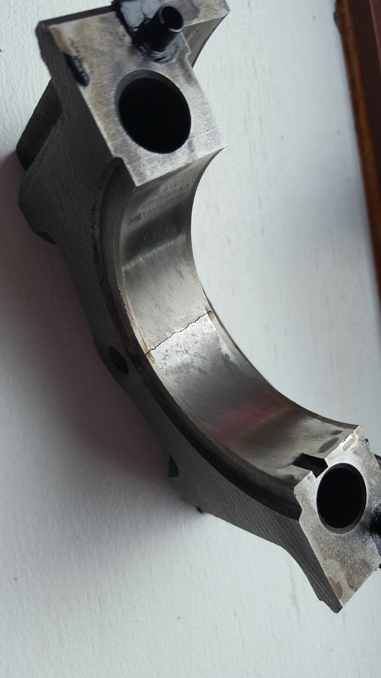

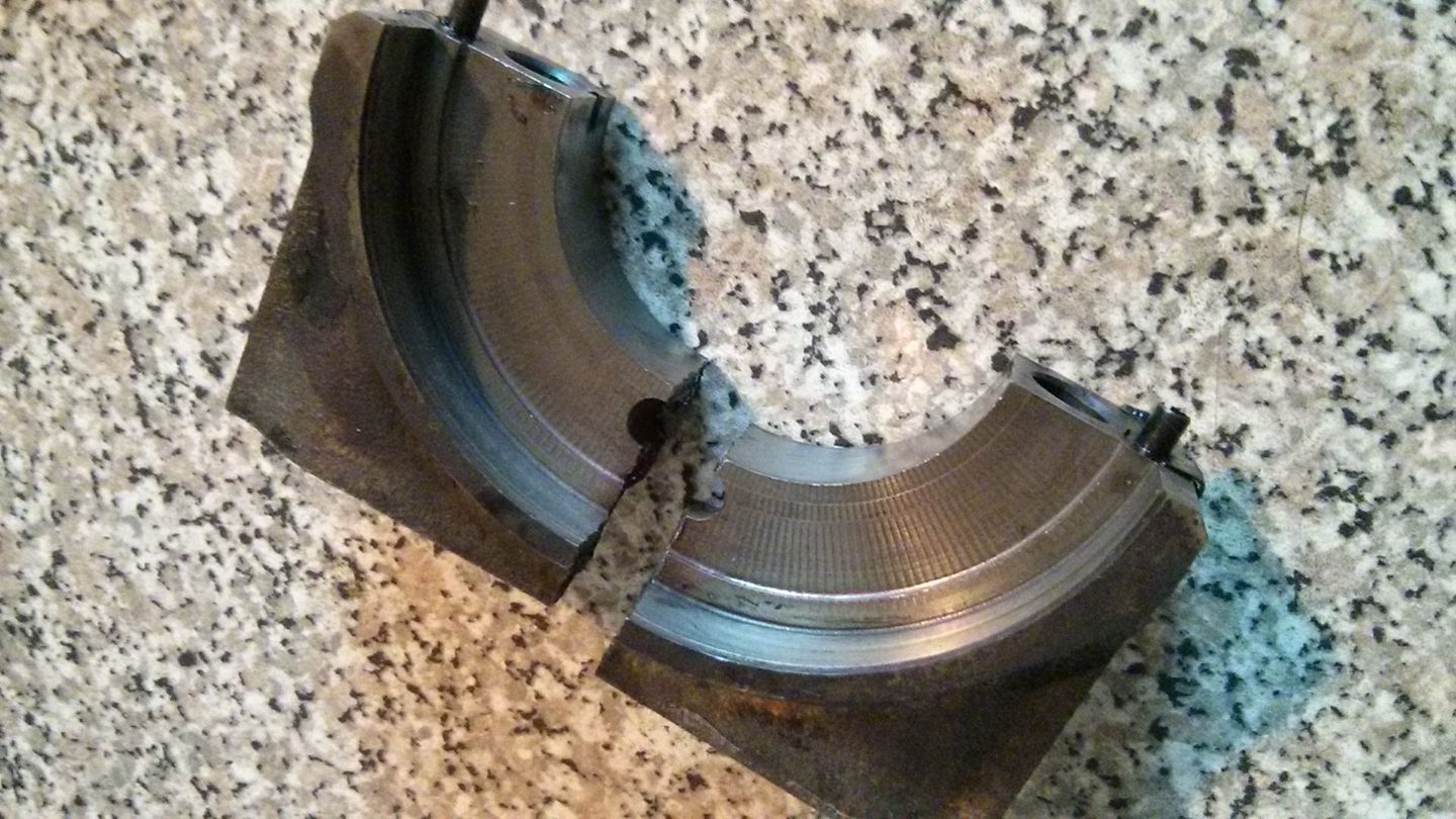

Hi, I recently bought a '97 boxer based 1.9td motorhome with about 80k on the clock and had it in the garage for an oil filler neck replacement and new alternator. Turns out the sump was leaking around the seal with the block so the mechanic removed it and found the main bearing cap closest to the gearbox had a crack in it.
New engine time
, I've read on here that a car engine could be modified to fit (the sump, oil pickup and flywheel etc) and have found an L reg 306xtdt locally that could be a prospect. Is this a straightforward job or should I hold out for an engine from a boxer? Appreciate any help on the matter.

Is your own engine not repairable?
If the crank's not damaged I'd be looking for a bearing cap from the breaker's yard, it won't matter if the donor engine is worn out so long as the part you need is good.
That break looks to have been caused by insufficient tightening of the bolts.

I agree with Gibbo.. grab a cap or three and try them? I presume the bearings are line bored so one cap may not fit all.. but you could be lucky if you have a couple to choose from.

In theory you cant just fit another bearing journal cap because they are line bored so are matched to that journal only but in practice i would go for it and get your mechanic to fit another cap, obviously the shells will need replacing. Odd one though, suspect not tightened correctly at manufacture?

or over-tightened maybe?

Bick wrote: 05 Aug 2017, 11:47 In theory you cant just fit another bearing journal cap because they are line bored so are matched to that journal only but in practice i would go for it and get your mechanic to fit another cap, obviously the shells will need replacing. Odd one though, suspect not tightened correctly at manufacture?
This !. Its either a replacement engine and sheds loads of cash. OR get a couple of caps,try them, and keep your fingers crossed.
That is a strange one though? never seen that in all my years with Peugeots.

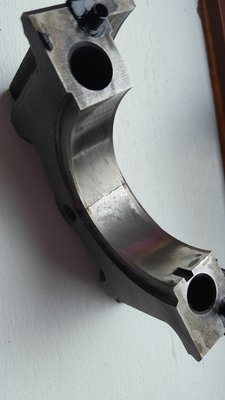

Thanks for the help lads, I am wary of swapping out the cap for another without line boring so going down the used engine route. I've been and bought a running 306 1.9td this morning that's had one lady owner from new (they all say that) and has 86k on it, just trying to minimise the risk since we hope to use the van in Europe. Everyone I've spoken to is stumped as to how the cap could be damaged. The van was running ok...
Here's the cap from another angle there's some slight pitting on the mating surface and it don't feel perfectly round.
