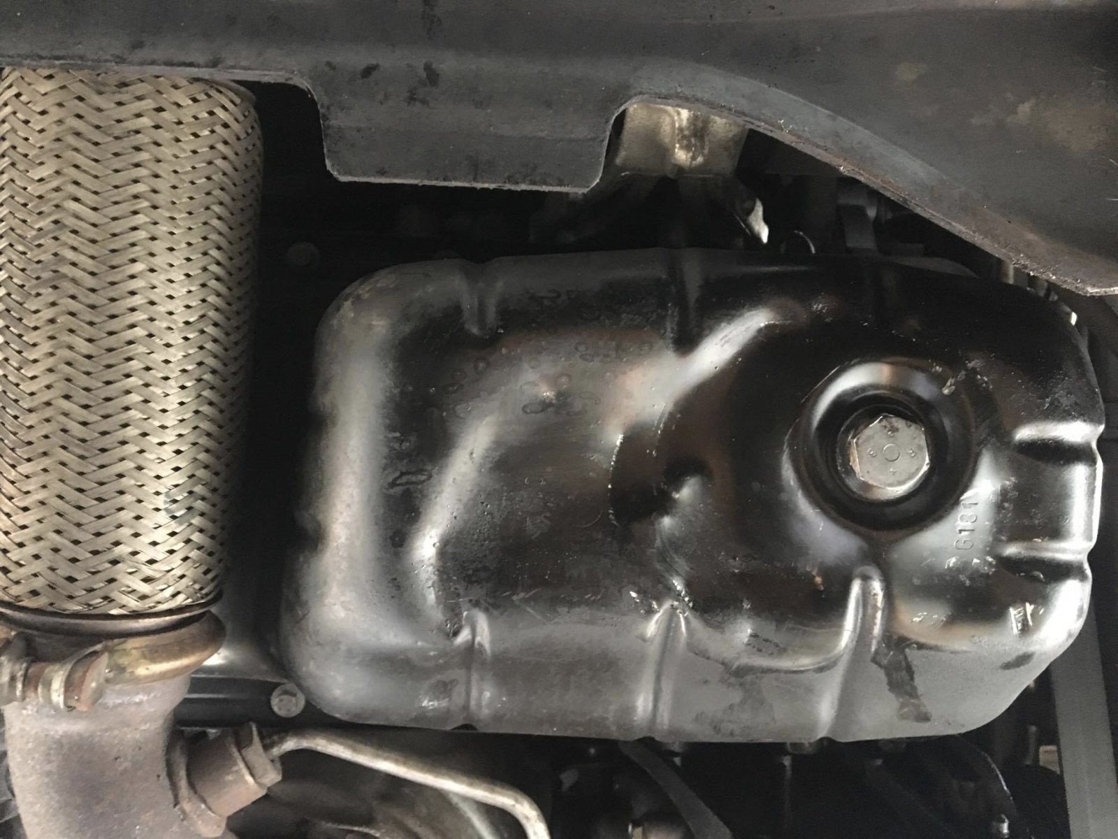

Just 3 weeks ago I went to a mechanic to get my timing belt changed on my 2009 Citroen C5 X7 1.6Hdi. Car had no error codes at all (a have a lexia3)
The next day after I took my car back from the garage, on the very first turn I got the "Warning oil pressure too low" message on the dash. I drove it home and left it for like two weeks parked in the drive because I was away on holidays.
Today after I searched this forum and the internet for solutions to my problem, I put my car on axle stands, took the engine splash shield out just to find out that my sump was bent.
By the way was the engine sump was in perfect condition like o month before I had to do the timing belt replacement because i have changed the oil myself and i saw it intact (as well the splash shield)
Also, after the repair the mechanic told me to sell the car quick because the engine was running bad and the repairs may be too expensive
I know my, I had it for over an year, the car was running smooth and still does apart from that error.
I think the guy from the garage put a trolley jack under the engine to lift it and bent my sump.
I've attached some pictures. From the pictures doesn't look too bad but the dent on it is quite big.
Any ideas what should I do next?
Many thanks, Lucian

Replace the sump and never use that garage again.
Really they should pay to fix it but as you didn't go straight back I don't think you'll have much hope.

I heartily concur with elma. The problem is that you cannot PROVE they did the damage, so you would not be able to get anything back from the garage. As it is your word against theirs it could be tricky getting a favourable outcome through a claims court.

I think it would be very difficult to prove that the garage was responsible, especially after this length of time.
As Elma says, take it on the nose and replace the sump.

I think the low pressure warning is because the strainer is now pushed onto the sump, so you might need a new strainer as well. If you can remove the sump you can probably straighten it with a hammer and piece of wood. I once bought a Saab 900 auto with atf running from the gearbox. Turns out the gearbox pan was damaged and I repaired it with a hammer and piece of wood, no leaks after.

I think of a new strainer as well (oil sump+strainer+oil=100 pounds)
In order to prove myself right i can print a report from my diagnostic tool to show the exact date when the error appeared for the first time, and it was the day I took my car back for the garage (same date on the bill), maybe that helps...

That could actually be a strong bargaining card.
Difficulty is that you have to give them the chance to put the damage right.
Personally I wouldn't want someone that incompetant to do a repair on my car. Especially as they must have known when they advised you it runs poorly.
So I guess its up to you 1. Approach the garage with your evidence and ask them to repair the car.
Or 2. Pay to fix it yourself / elsewhere.
There is the possibility of claiming the money back from the original garage afterwards but you'll need an engineers report and its a bit of an ordeal to get into that will cost about the same as the repair. Laws funny in this country so even if you think you have 100% proved your case your chances of winning are more like 50%. Once you do win getting them to pay up can be almost impossible and very stressful.
My advice for in the future is that if somethings not right on a car after garage wirk take it straight back. If you've only driven to the end of the road and back then your position is a lot stronger.

It's got to be worth asking them to fix it - although it's a pretty shoddy outfit that would do that and not fess up to it and offer to fix it. I would want to be in the workshop when they do it, and make sure that they use the correct C2 spec oil when refilling.
Getting the sump off is not too hard - you can do it without removing the exhaust section, and the two studs at either end have a built in collar which pulls the sump off when they are undone.
If they're not interested, then get it fixed then sue them in the small claims court for the repair costs. And report them to Trading Standards.

If you don't trust them to do the job and you can get them to agree that they are culpable then perhaps they would agree to supply you with a sump and pickup.

I wouldn't be going near that garage again, and certainly not trust them to do a sump replacement.
If you can replace the sump etc for around £100, best just to do that - at least you'll know it has been done well.

Replace the sump and check the oil pick up for damage it may be cracked so check carefully. Have any work the garage did inspected and never ever go there again, to put a jack under a sump is so bad you know they are NOT mechanics. Sorry mate but you do really need to keep away from that garage and try and get compensation through your legal process.
