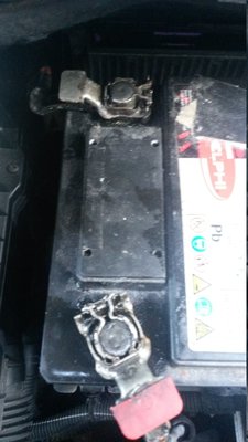

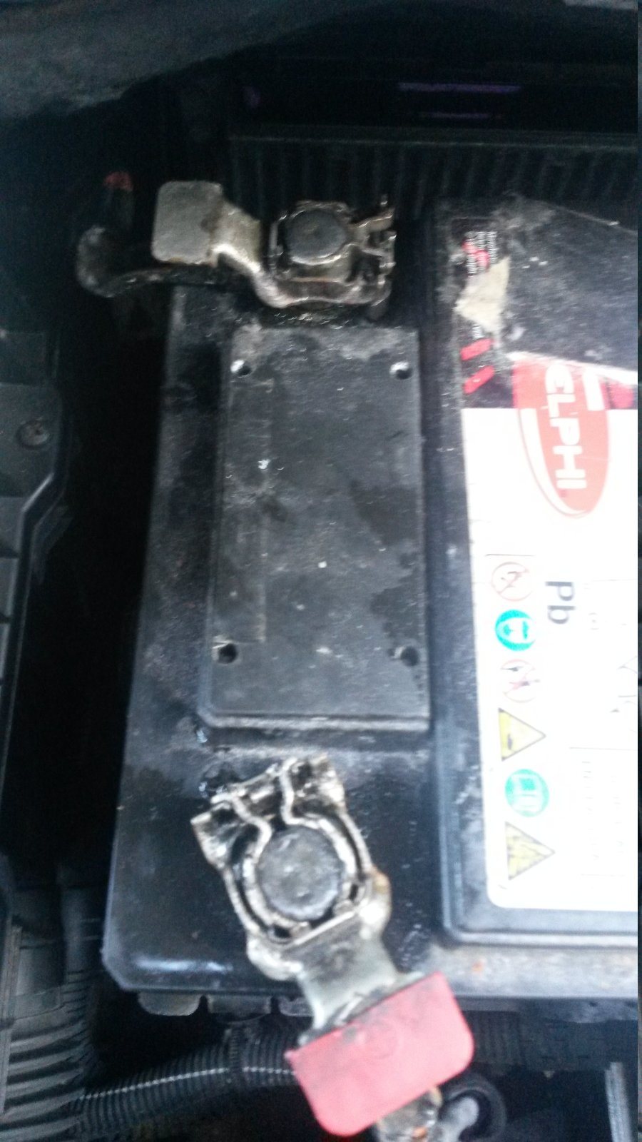

Could be worth checking the condition of the main battery connectors (and if crimped-on lead (Pb) type, replacing them with brass clamps, and cleaned-up strands.) Original battery connectors acquire resistance with age, and during cranking can drop system voltage enough to prevent other electronics from working properly.
Starting only with a jump or warm is a clue.

white exec wrote: 23 Jul 2017, 19:45 Could be worth checking the condition of the main battery connectors (and if crimped-on lead (Pb) type, replacing them with brass clamps, and cleaned-up strands.) Original battery connectors acquire resistance with age, and during cranking can drop system voltage enough to prevent other electronics from working properly.

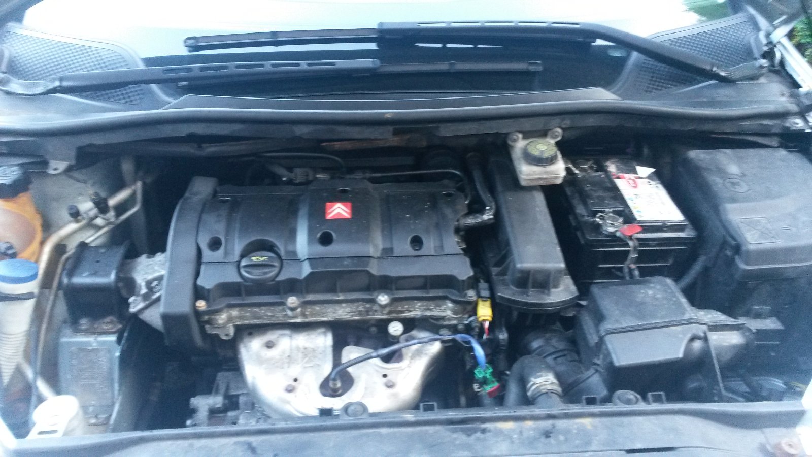

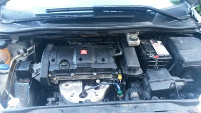

Sorry guys but it failed again, still won't start, just tried and it keeps turning until battery runs out, had another one on full charge and still not starting on full charge, Don't know what made it start this morning.

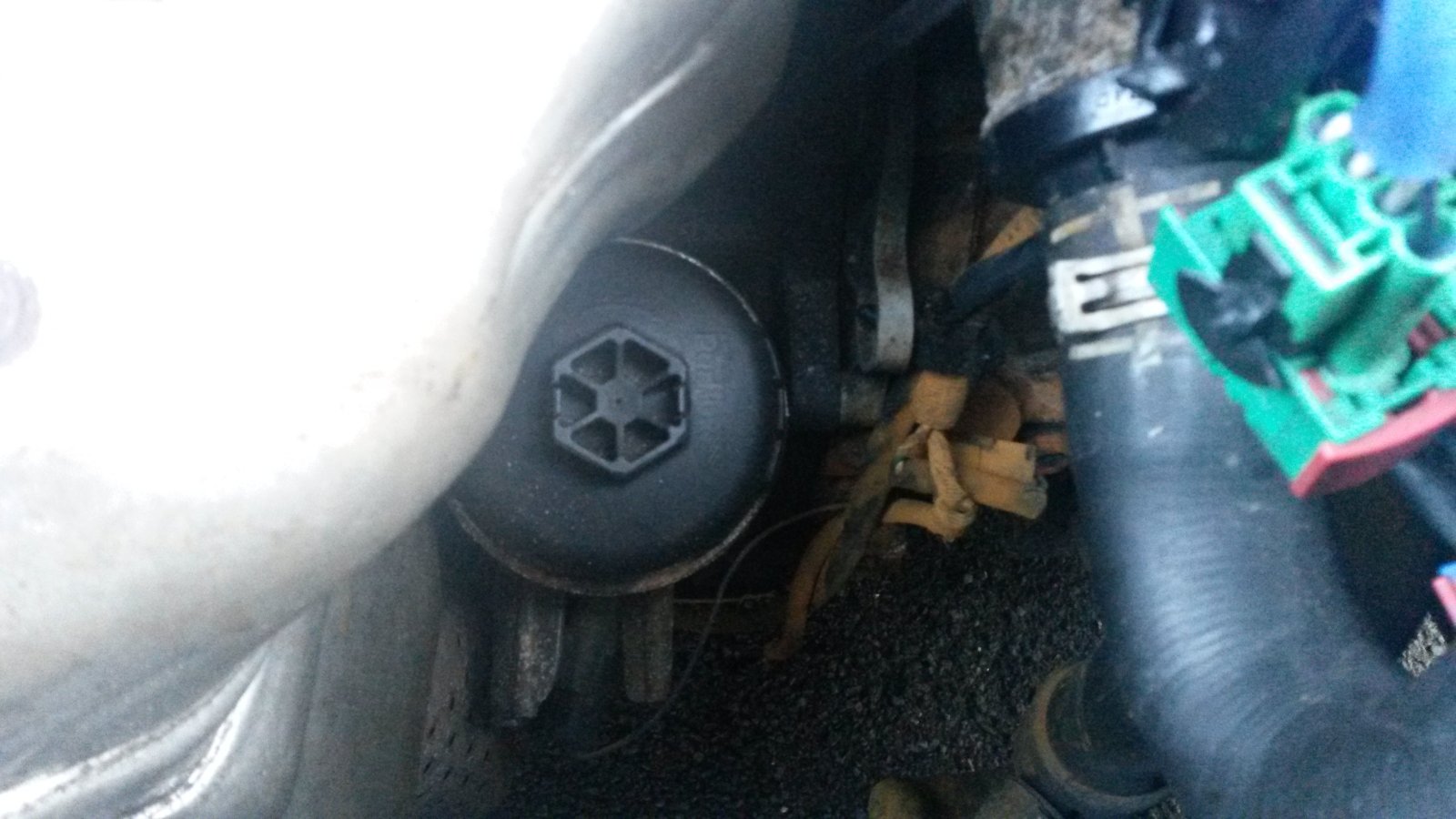

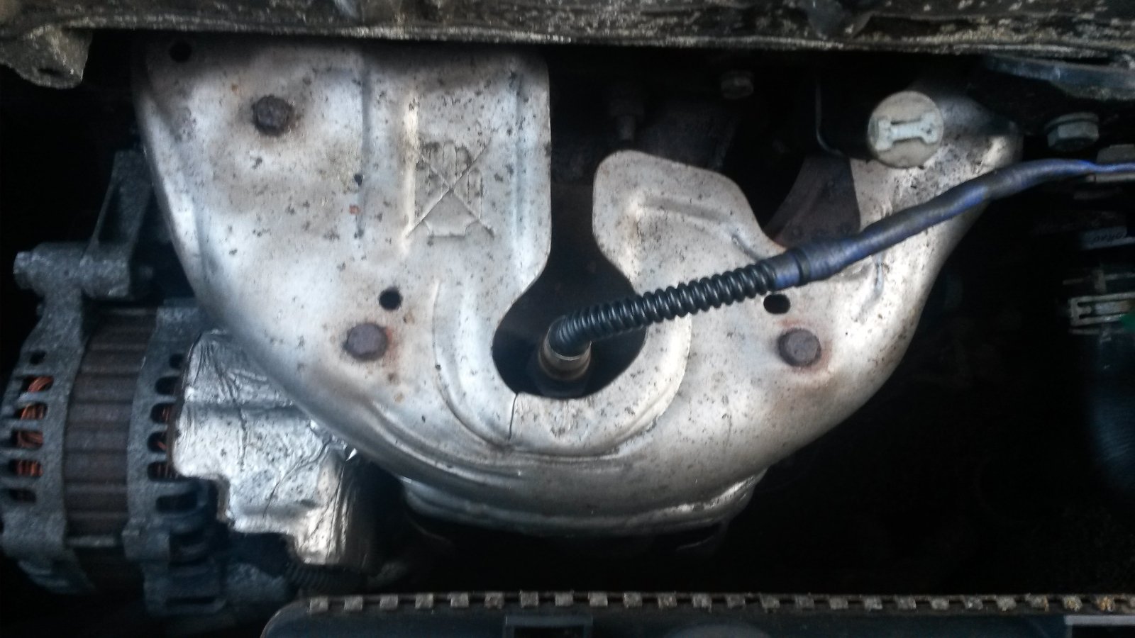

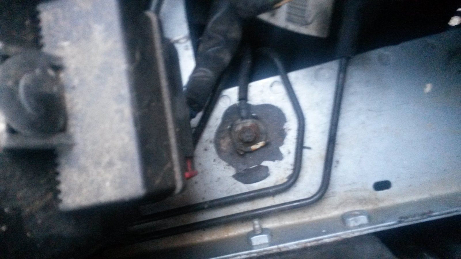

Here are some picture's I've taken. I'll take look some more tomorrow..

@411514, It can't be crank shaft sensor as it's cranking, could be an o2 sensor. But I still think it might be a wiring or grounding issue.
Even with Jump lead it takes a few tries before it does.
- Posts: 12573
- x 1485
Re: Citroen C4 2005 Petrol, not starting.
Crank sensor doesn't stop it cranking, it just tells the ECU the engine is going round. It won't be O2 - this is only used once the engine has warmed up a bit. You need to get it on a diag computer and get some live data to see if the ECU can see the engine rotating, and / or if there is anything else amiss.

What are thoughts on Cam-sensor? I've just seen lots of yellow rusted soot showing in picture 3 above, on wires and bolt.

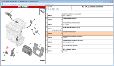

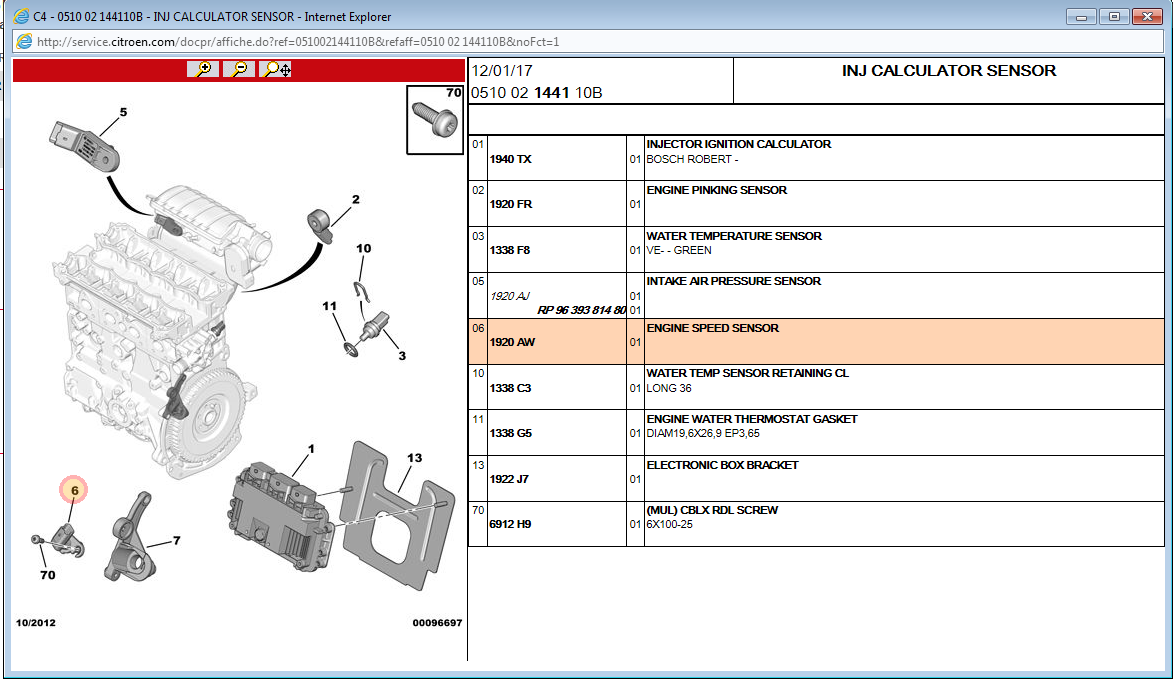

Part number is 1920 AW. Citroen charge £30 inc VAT, but you may find it cheaper on ebay.
No way that I am aware of to test the crank sensor (without a Lexia). Simply a case of replace and see. Should point out that I am not absolutely certain the crank sensor is at fault, it is just where I would start before wasting time and money elsewhere.
To my understanding the engine doesn't have a cam sensor. Might be wrong though.
See attached image from service cit for positioning of crank sensor

The best & most accurate way to test an inductive crank sensor is with an oscilloscope.
The rusty residue looks to me like the crank sensor is totally covered in it, the crank sensor (and its connection) would deffo be suspect on this car. You will need to find out where its coming from or the same thing will happen to a new sensor.
Don't believe there is a cam sensor on this engine.
411514
- (Donor 2017)
- Posts: 423
- Joined: 14 Dec 2010, 15:26
- x 40
You're right Wheeler about the residue on the crank sensor. I didn't spot that. Is it dried coolant?
