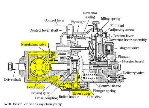

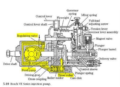

Oooh, this is interesting (for me)! As Jim says, the engine light can betray a fuel flow restriction, which can throw the timing advance out of whack, hence the warning light.
However IIRC, this usually manifests at higher rpm/fuel flow, whereas yours is only happening at low rpm/fuel flow and clears as the rpms/fuel flow increase.#
Definitely follow Jim's advice and eliminate the fuel supply system but I'm wondering if it could be the pump showing it's age also. Let us know how you get on.
#The diesel pump, unlike modern common rail systems, is internally both the low-pressure "lift pump" and "high-pressure injection pump". It is the former part that creates the required pressure for the timing advance module to work from, as well as drawing the fuel through from the tank, the fuel lines and fuel filter.
This is achieved by spinning 4x free-sliding "vanes" in an elliptical orbit to paddle the fuel, creating the desired pressure. If these vanes stick or are worn, the required pressure may not be achieved, especially at very low rpm.
Equally, (though not likely the cause in your case) there is a spring-loaded pressure regulator that will open and relieve any excess pressure (as the pump spins faster with higher rpms), keeping the pressure constant. If this device is worn or gummed, it too will affect the factory-set pressure.
