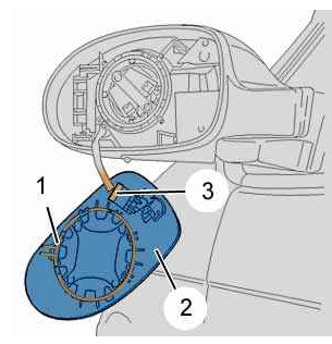

I would like to ask for your help again. I've found at a breakyard a mirror and I would like to ask for your guidance /instruction hoe to replace the mirror. do I have to take off all the door panel or there is a way to dismantle only a part of it? any tips to avoid causing damage? thanx for all the help that you're able to offer.
one more thing - is there a way to change the outer shell of the mirror? I would like to remove the one that I've bought since its color is not as the color of the vehicle and the the outer shell of the original mirror is not damaged and in good shape.

Avi, below are a couple of diagrams to help you with changing the mirror glass:
Removing the Glass Mirror
Unclip the clip ( 1), Using a thin screwdriver.
Disconnect the connector (3) (according to equipment).
Remove the glass (2) from the mirror .
Replacing the Glass Mirror
Ensure that the spring clip ( 1) is correctly located in its mounting.
Reconnect the connector (3) (according to equipment).
Clip the unit onto its support.
You can replace the outer shell of the mirror (the casing). They are generally supplied unpainted from a dealer - necessitating a lot of prep and painting - so assuming you will be trying to source an identical coloured one, this should show you how it is clipped on:

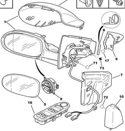

Hi Marc and thanx for your explanations. I'm afraid I was misunderstood. it's not the glass that was broken. the glass is in tact. the whole mirror was broken - the pivot that the mirror is turning on was broken. as far as I can tell - the whole unit (with the triangle base that is attached to the door with the three screws) needs to be replaced. I wish only the had been broken, it would've been much easier.
- x 6950
Re: C5 left hand side mirror
Ok, the complete mirror is available from Europe (but can be expensive as yours is the driver's left hand mirror), but there is a company called Alkar (Spanish I think) that make replacement new mirrors and other components for various manufacturers. This is the one for your car:
The PSA part number is 8149 WL (for the complete mirror, excluding the shell, but most second-hand ones will be complete no doubt)
The equivalent Alkar part number for your car is: 6129852
This is the link to Alkar for more info - as you can see it is electrically foldable and comes unpainted with the shell (but I think you'll need to locate a reseller):
http://www.alkar.es/en/online-shop/mirrors/6129852.html
and here is a link to an ebay (UK seller) selling these new - the only trouble is this particular seller doesn't seem to ship to Israel Avi.
http://www.ebay.co.uk/itm/Outside-Mirro ... 2548.l4275
It may be worth having a search and contacting some of these regarding shipping though. There was another one I saw that does ship to Israel , the same Alkar mirror from another company, although the shipping was a bit more than the cost of the mirror - but still less expensive than the second hand ones I've seen in Denmark that wanted over £230!
Here is the link, it was £64 new and £74 postage. The £64 cost includes VAT at 20%, so whether they would take this off the price - might be worth an ask...
https://spareto.co.uk/products/6129852-outside-mirror

Hi Marc and really thanx to your efforts and time. as I've mentioned before - I've bought a complete mirror from a carbreakers yard. the color of the shell is some sort of red and I intend to "swap" it with the original shell from my mirror that was broken down due to the collision but the shell remained in tact, only the pivot was smashed.
could you tell me please what have to be done in order to replace the whole mirror? the is a small plastic triangle cover at the front side of the door that cover the three screws that attach the mirrors base but that not enough since the electrical connectors aren't reachable and it seems that the door panel must be removed or there is a simpler solution?

you could try undoing the three screws then give the mirror a knock to remove it.. the plug connector may be hidden in the door but a tug on the cable may bring it out into the open?
- x 6950
Ok, so as John says, you just need to undo the triangular trim piece and remove the bolts - but you will need to take the internal door card off to access the electrical connector:
Have a look at this Russian video - he struggles a bit, but gets there in the end - it may help you visually to see the trim parts and how to take them off.
I must admit to watching it previously - for entertainment value alone - I am sure there were a few choice Russian phrases uttered!

Thanx for your comments. I've already removed the inner triangle cover but the harness is only visible and pulling it didn't revealed the connector and I don't want to apply too much force. I'll watch the video - hope it will help.

Hi Avi, you cannot pull the cable to release the connector. When you remove the door panel you will see the cables are about 3-400mm in length. They go down behind the panel then loop up and connect to the underside of the control module. The panel is mostly held on with plastic clips but there are one or two screws in the rear edge near the doorlock. There are also four screws I think behind the speaker, the speaker cover should just clip out with a small screwdriver. Also there are two large screws holding the pull handle to the inside of the door, the plastic cover should prise off to reveal the screws. However, you will have to remove the window switches first, just use a small screwdriver to ease the them out and you can disconnect the wiring plugs, these can only be fitted one way because of their shape so don't worry about getting them mixed up. I think that's about it, use a flat blade screwdriver around the edge of the panel to release the plastic clips, or a fancy tool if you have one
Once it is all loose lift the panel slightly to release it from the door and all will be revealed, you will be amazed at the amount of cables in the door! Also I nearly forgot, in the UK the temperature sensor is in the left hand mirror you might have to release it to fit into the new mirror.
Once you start and work out where all the screws and clips are it's not as bad as it sounds.
Dave
- x 6950
demag wrote: 21 Jul 2017, 23:40 in the UK the temperature sensor is in the left hand mirror you might have to release it to fit into the new mirror.
On the left hand drive models the external temperature sensor is in the right hand side mirror housing, so no need to worry about that.
