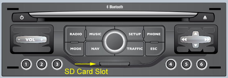

If your Head Unit has the SD card slot as shown, then it is the MyWay system and no additional menus or options available. See below:

Yup, that's the "beast"
