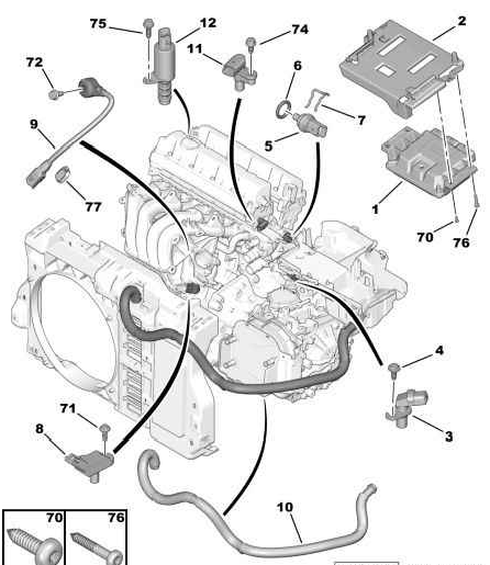

Ok, so part 5 on the diagram - there are 2 water temperature sensors types for your car, depending on housing:
Part 1338 C1 Green
DIAM 25,4-LONG 53
FOR PLASTIC HOUSING
OR:
Part 1338 A7 Green
M12X150 2 VOIES (track?)
FOR ALUMINIUM HOUSING
Gasket (part 6 on the diagram):
Part 1338 G5
ENGINE WATER THERMOSTAT GASKET
DIAM19,6X26,9 EP3,65
In Case you need it
Water Temp Sensor Retaining Clip (part 7)
Part 1338 C3
Long 36
Part 1338 C1 Green
DIAM 25,4-LONG 53
FOR PLASTIC HOUSING
OR:
Part 1338 A7 Green
Part 1338 G5
In Case you need it
Part 1338 C3
Long 36

Ok, thanks a lot! I just tested my car, cooling system works fine, cooling fluid is at correct level, so I think it have to be temp. sensor error (most likely) or cooling fan wiring problem.
- x 6950
Re: C5 2008 2.0i cooling issue
No problem - but more likely the sensor if the fan has been working - but obviously with the A/C not working until you get the condenser.
