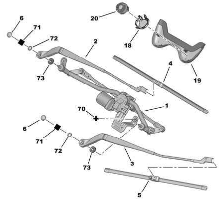

Ian
You have the conrod assembly unit as above - item 1 is the motor, part number: 6405 PQ
Here's one for £113:
http://www.ebay.co.uk/itm/Fiat-Ducato-P ... 2128982031
The only other thing I could think of is the Comms Module (under the steering wheel that houses the wiper and indicator / light stalks. It is a possibility that the circuit in the stalk might be worn for the intermittent setting - but hard to say without a physical examination I'm afraid.

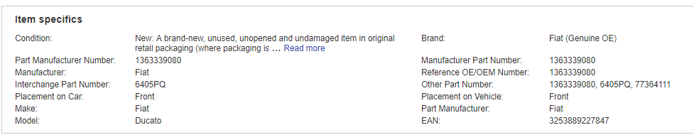

Ok Ian, so the part in the following link:
http://www.ebay.co.uk/itm/Front-Wiper-M ... xyOMdS-ofS
is stated here that it equals part 6405 PQ - which is the correct part number for your vehicle according to your VIN: (Click pic to zoom). This contains the con rod assembly and the wiper motor.
