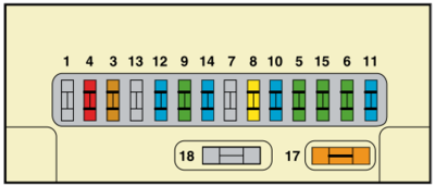

The shunt fuse James mentioned is worth checking - on a 2008 model it is in the passenger compartment fuse box, number 18 on the diagram below:
C2 2008 Shunt Fuse
C2 2008 Shunt Fuse

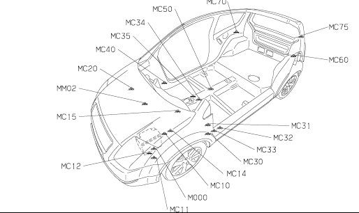

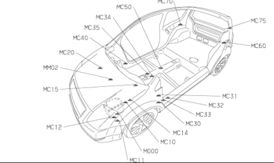

One other thing to check is all the earth connections - If dislodged or corroded a bad contact can play havoc with the electrical systems. This is where all the earths are located and the descriptions:
M000 battery earth
-MC10 front left earths
MC11, MC12, MC14, MC15
-MC20 front right earths
-MC30 front left earths (dashboard)
MC31, MC32, MC33,
-MC34 centre console earths
MC35
-MC40 front right earths (dashboard)
-MC50 central cabin earths
-MC60 left rear earths
MC75
-MC70 right rear earths
-MM02 engine earth
