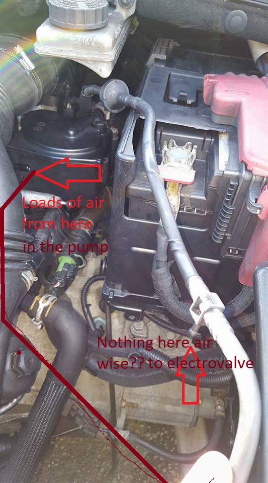

Haven't got hold of a gauge tester yet to check pump but interestingly from checking pipes i've found something odd as i've highlighted in picture below, any explanation? Disconnected to electro valve hoping to feel something flowing through with it connected to pump and nothing can be felt
Also my brakes feel fine which doesn't really add up if there's an issue pump to hose?
