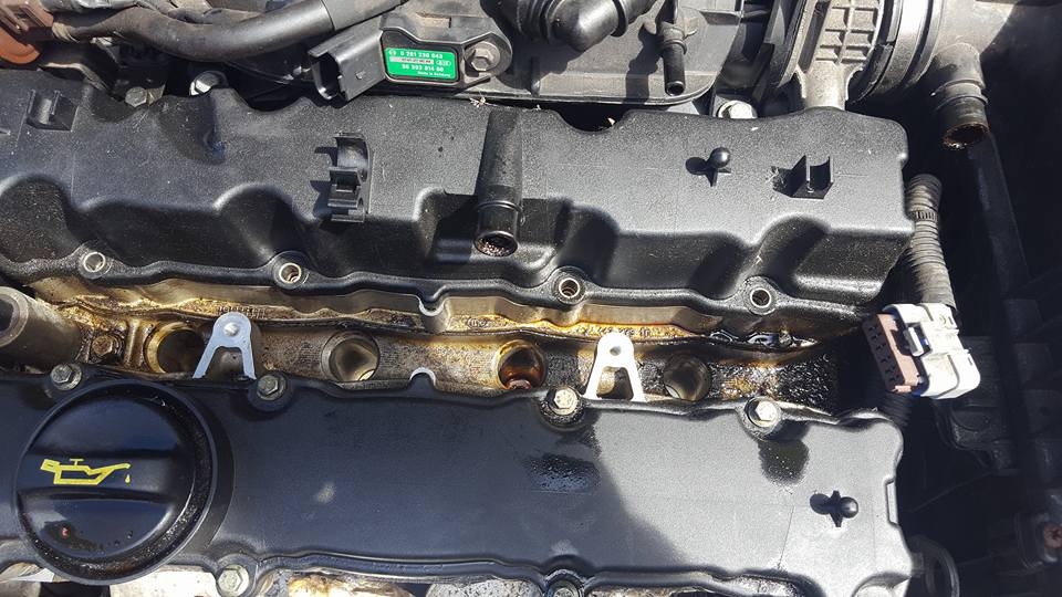

Well, the 1.4 engine has a reputation for leaking oil from the head gasket as we know. Mine has already had a head gasket replacement some time ago, but on 85k miles, was leaking oil again. I hadn't really inspected it, as I presumed it was the head gasket, and I would just keep putting oil in it rather than shelling out to get it fixed. Anyway, in the hot weather a few weeks ago, the smell of burning oil began to annoy me, so I had a look and discovered that the oil appeared to be coming from the cam covers, rather than the head gasket. Today I finally got around to attempting to fix it.
It was everywhere.

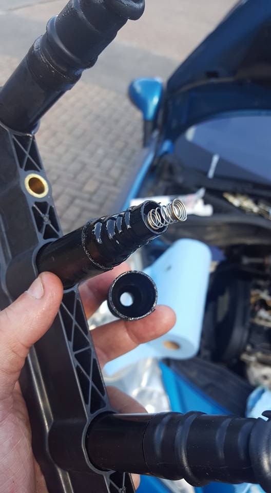

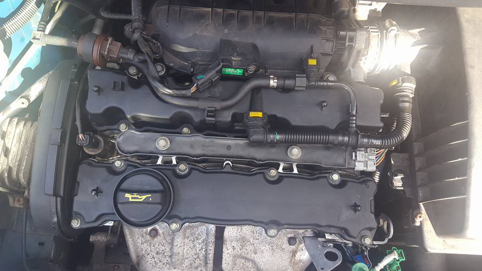

It appeared to be leaking mainly from the front edge of both cam covers. The plug wells were full of oil, the plug boots had filled up with oil. The whole lot was removed and cleaned thoroughly with brake cleaner and rags.

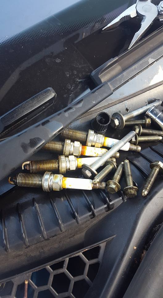

Utterly filthy. I've also seen plugs from my old 2-smoke bikes with less oil on them when removed than these!

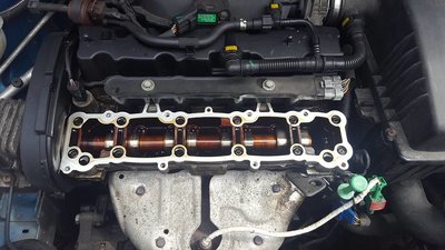

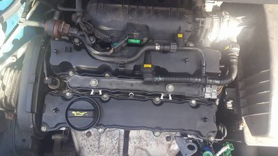

So, I cleaned up the gasket face, which was just covered in oil. Cleaned it properly, and reassembled with a bead of black silicon around, taking care not to get it in the oilways.
I did the same to the rear cam cover afterwards, but I didn't take pics as my battery was flat. Much the same as the front, apart from having to unhitch a couple of pipes and sensors. Of course, I dropped a bolt down the back of the engine, which I can see and not reach at all - just under the green label on the plenum. Fortunately, my TV wall-hanging kit had a couple of bolts unused that are exactly the same size.
Now it's all back together and so far, it's dry. I have taken it for a spin afterwards, and checked it, and it remains dry so far.
