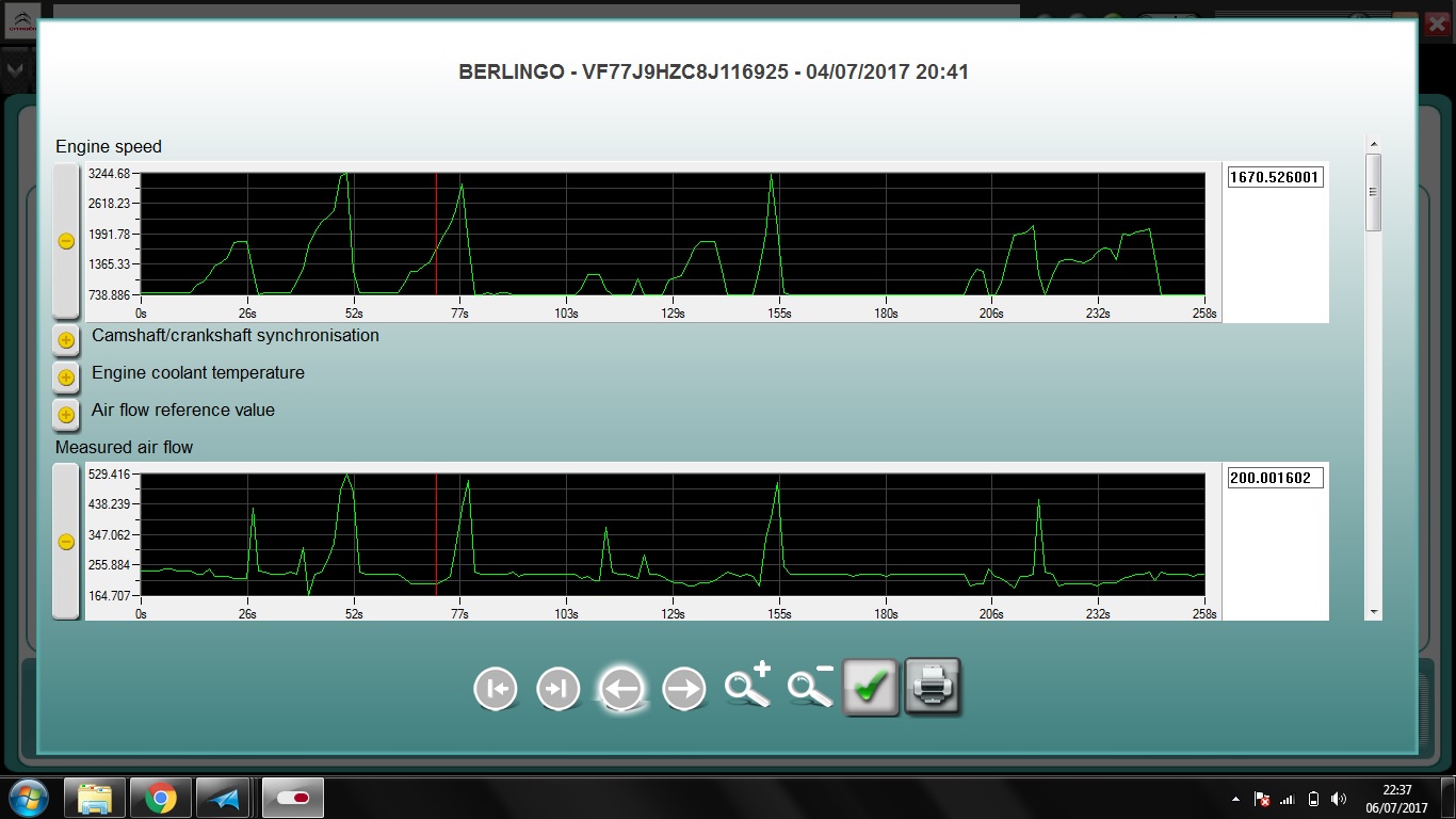

Hi, i am having major issues trying too diagnose my egr issue.
I have had a new one fitted, same faults are appearing.
The car suffers from hesitation around 1700 rpm .
P1459 P0490
Valve opening too small
@2666 rpm relative position 46%
valve position 9%
@2699 rpm relative position 49%
valve position 9%
I'm confused! what is the actual problem, description says opening too small which makes sense as that would starve the engine of some air. So should it be at 46% and it is actually at 9% ? thing is it works fine above 2k rpm.
Please can someone advise me of my pinnouts so i can test the harness etc.
Berlingo b9 1.6hdi 110 bhp
Thank you

Re: egr help pleeeeeease!
Have a look at my airflow, it actually drops from 1000 rpm until it reaches 2000 rpm
Sorry, I can't access wiring diagrams based on Vin numbers.
Are those the exact and full error code messages?
Have you cleared the fault codes first?
Have you tried a BSI reset?
Are you confident the replacement EGR is a good one. the internet tells me there's far too many dodgy ones for sale and most recommend getting a genuine replacement (Valeo I think)?
Does your engine also have separate EGR throttle?
Does your engine have DPF? What is the Soot Loading and when was last regen?
