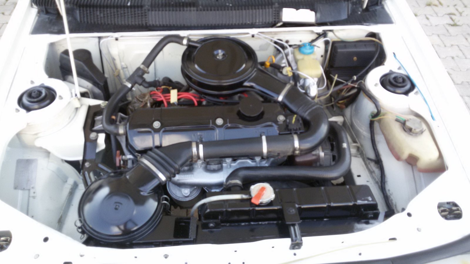

I have a Peugeot 305 1.3 Petrol (engine code XL5) 4 speed manual transmission year of production 1984 with 200000 km on it, it has been mine since new.
Yesterday I took it for a short drive and noticed a clicking sound from engine cylinder no.3 which continues to click when idling or in higher RPM, I was thinking that the Valves has come out off adjustment but when I went to Peugeot shop the last technician that knows these engines has retired.
I has done valve adjustment in other cars but I don`t know the clearances for this engine the intake and exhaust, if anybody knows please let me know this specifications, and do you think that are the valves or any other thing?

This: http://www.sehlin.com/bildata/peugeot/peug26.htm suggests 0.25mm exhaust / 0.1mm inlet.
Not familiar with this engine, but it looks pretty similar to the engine that was used in the Visa etc, although it was put in nearly horizontal. This is known for wrecking camshafts unfortunately... First thing I guess would be to get the rocker off and check the clearances, and for any obvious wear on the camshaft, and then take it from there.

These were notorious for wearing a hollow in the valve rockers (usually due to neglecting the oil changes) but it was possible to replace them in situ.

Gibbo is spot on when he says these engines wear a lump out of the rocker arms,the camshaft lobes will be worn as well. All you can do is adjust the valve clearances and see (or listen). inlet valve .10mm exhaust valve .25mm.
You will have two choices. Live with a tappety engine,nothing will happen it will just rattle for ever. OR? a major and expensive strip down.If you can get the parts that is? This is a job for an old school Peugeot mechanic who has had experience with these engines.There must be some in Kosovo ?

If you start looking for parts, The XL5 engine in a 304 is the same as your 305.so the rockers and camshaft will be the same.

Thank you Oldpug for your reply, I did adjust the valves and there isn`t noise in idle and low rpm but in high rpm you can still hear the clicking and that it`s not a happy engine, so this leads me to other opinions that I read on a Volvo forum for the same problem.
Can you tighten the vales more than factory specs 10 and 25 to 5 and 20 considering the fact that there is much more wear on engine components than factory supposed and the other fact is to put thicker oil from 10W/40 to 15W/40 or will it put a load on oil pump and destroy it leading to complete engine failure ?

The noise is the worn rocker arm,there will be a concave bit worn into it by the camshaft lobe. Tightening the clearances will achieve nothing.As I said it will just rattle for ever,nothing will happen or blow up.Its an old and very tired engine,just live with it. All you can do is change the oil and filter,making sure you have the correct Peugeot oil filter.I would fill it up with classic 20/50 oil and add a can of thick fortifier,like Wynns or Forte or STP. I`m sure they have the stuff out there? its like thick treacle.
