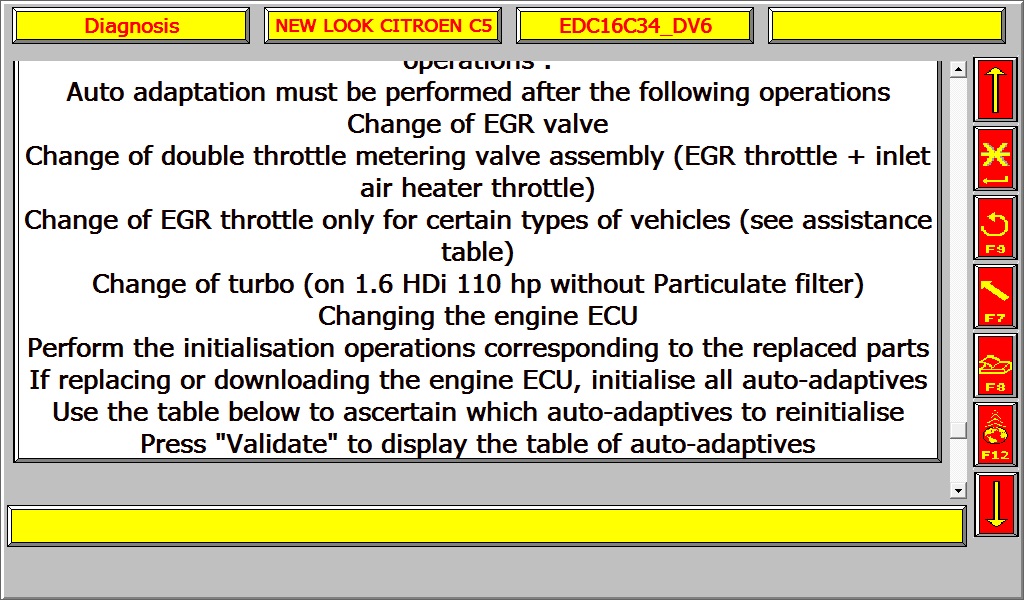

RichardW wrote: 21 Jun 2017, 12:11 Presume this is a 1.6? No need to program the EGR - it does it automatically at key off by cycling the EGR valve open and closed.
Interesting, my lexia states you do have to carry out auto-adaption after change of EGR.

RichardW wrote: 22 Jun 2017, 06:36 Interesting.... I didn't do anything when I replaced the valve on our C4 - I'll have to have a look in Diagbox sometime and see if there is an option. It doesn't say anything about doing it when replacing the valve in the service.citroen docs I have.
Purely speculation on my part but I have noticed that my copy signal is often a fraction different to the command signal, especially when it's closed. I wonder if I were to follow the procedure, this minor discrepancy would disappear and, perhaps, the annoying hesistation/flatspot.

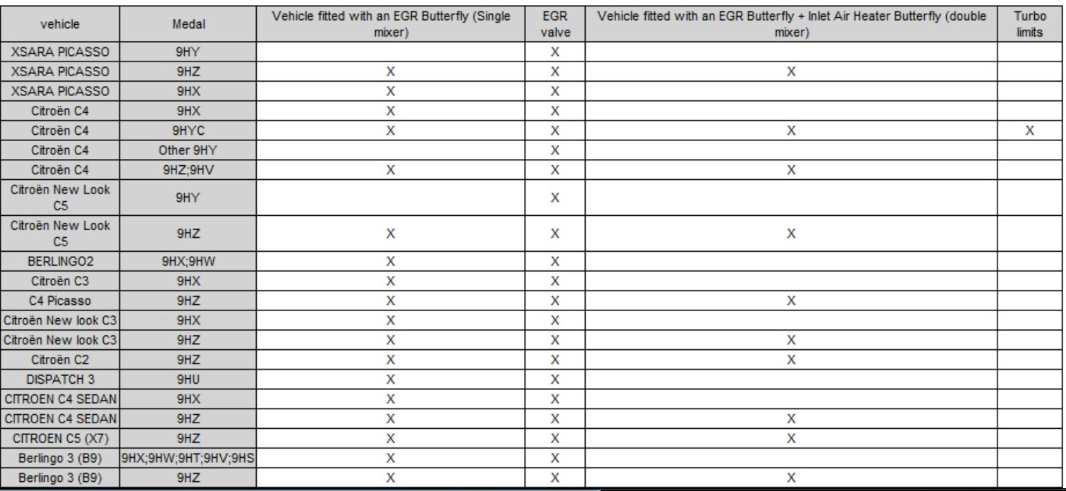

Re: measured air flow
Auto-adaption table according to model.
