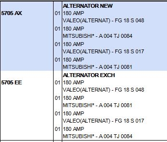

Righty-ho, it's as clear as mud :) I've used my VIN to check - mine being a 2009 2.0Hdi VTR+, and this is what it says......
However.... a generic look-up for a 2.0Hdi C5 X7 gives a result of 10 different new alternators to choose from and the same for exchange - most of them are 180 amp, but a few are 150, so your VIN is really needed for an accurate answer :?

Thanks for the reply. :)
VIN is VF7**************[VIN obfuscated, can be read by forum staff].

I managed to get the part number - its a Mitsubishi one, A00 4TJ 0084C. I've found a few used ones from breakers, but the best one seems to be a recon unit with 12m warranty for £87 delivered, no surcharge as they expect the old one to be ready to go back when they deliver. Seems reasonable enough, so think I'll take the plunge tomorrow - and a mate's doing the job for me inexchange for a few bottles of very nice red wine! :-D
