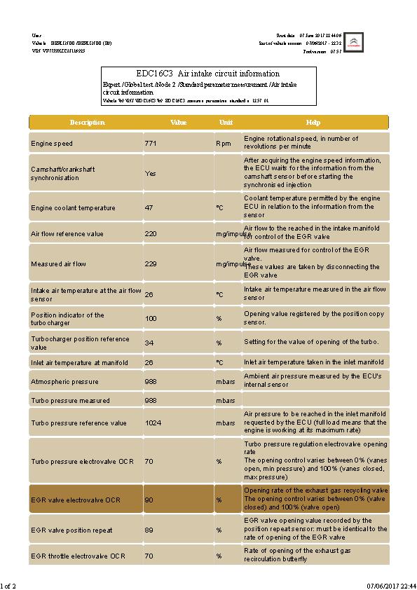

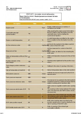

I measured sensor voltage back from MAP, 2.39v at idle, it does go up with acceleration. I thought the voltage should be around 1v!
I have diagbox but unable to read fuel trims, not sure if this is possible.

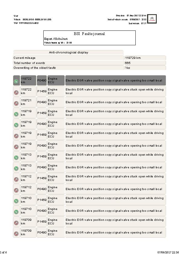

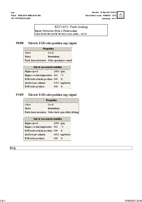

I have attached fault logs from ecu and 2 x faults.

The symptoms match a failed EGR; and that is what the fault codes are supporting. What valve was fitted? If it wasn't a genuine Valeo one, then I would seek one out ( you can get from e-bay for £100) fit that and see where it takes you.
