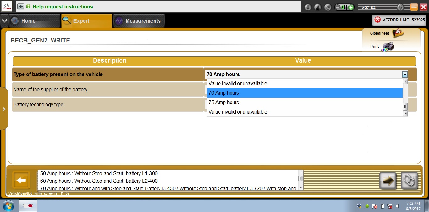

Hi all,
does anybody know if I can declare new values for battery with diagbox? I have only 3 values: 60,70 and 75Ah and I'm restricted to choose a new battery.
I know that I have to declare the Ah value accordingly to the value of the new battery but I didn't find where.
The car is c5 exclusive 2012 2.0hdi 163hp

That picture is so small we can't see any detail and it won't zoom.
The recommended for your car (163) is 720A (Cold Cranking Amps) and 70AH (Amps / Hour), so select 70. The 75AH is for the 3.0 LV6.

Sorry for the small picture.
The idea is that I will buy a aftermarket battery and it will have a different value, like 77Ah or 80Ah and usually a 70Ah battery have the Cold Cranking Amps smaller than 700A.

That's fine - declare the nearest value to the battery you get

I found Exide premium and Tudor (belong to exide group) 77Ah / 760A both and I will set 75Ah in ecu.

I changed the battery with new one exide 77Ah 760A and I tried to declare 75Ah with diagbox but every time I get configuration error.
It only worked when I changed the "Battery technology type" from Freezing to Other. In that moment when I did the configuration the car was in Economy mode and suddenly come out from economy mode.
Battery technology type should be Freezing or Other? With "freezing" I can setup only 70Ah battery.

Can you advise where in Diagbox you are trying to change these values? What menu are you in?
