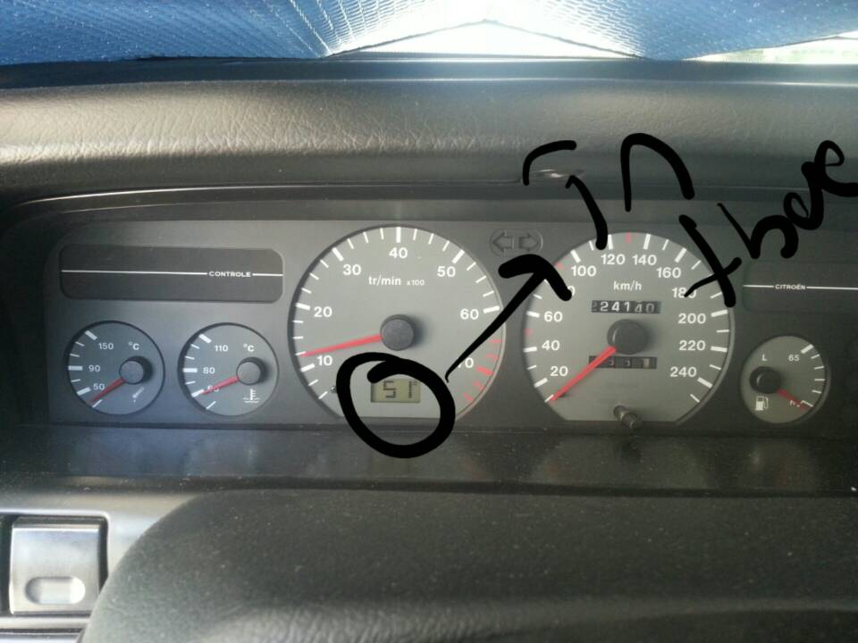

Hey guys
In my dashboard is showing rarely F4 fault code?do you know what is f4 fault?Image

I do not understand what you mean by an F4 fault code?
Are you saying the outside temperature display shows 'F4' rather than a valid temperature?
51 degrees seems to be very warm!
Yes,i am saying it.
Here is more hot from 51 degrees in summer [emoji33]

Gosh, that's warm!
mustican05 wrote:Are you saying the outside temperature display shows 'F4' rather than a valid temperature?
Yes,i am saying it.
In that case it's not a fault code. It is most likely to be a faulty temperature display module or a faulty temperature sensor... The sensor is mounted in one of the door mirrors and can be seen as a little bump underneath it. It may even be a bad connection on the sensor although bad connections usually case two bars (--) to be shown on the display
How often does it happen?
If only occasionally, I'd not worry about it; it is nothing serious...

It does sometimes.thank your reply.i will check wire Connection.
