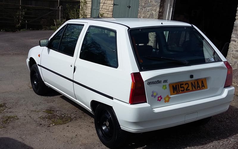

plastic trim never looks blacker than when it's set against Blanc Banquise paintwork. Never really appreciated just how bright a white it is until Tuesday when White arrived at her new home. Noir Onyx however, shows up the slightest imperfection in the trim inserts!
