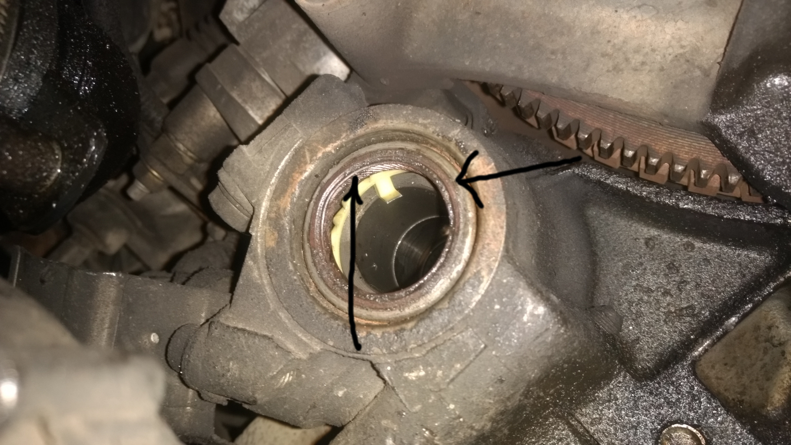

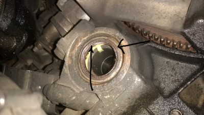

davoxx
- Posts: 517
- Joined: 02 Jan 2011, 23:40
- x 15
Re: xantia drive shaft seals
Drive shaft seal fell out, I removed the metal ring part, but I assume the part above the plastic bit in the pic needs to come out too? And what's the best way?
why?
- Posts: 55063
- x 8386
Yes...
Lever it out with a small pry-bar being careful not to scratch/damage the housing...
You will need to put a small block of wood under the opposite side to where you lever to give the pry-bar a fulcrum on which to effectively work.
