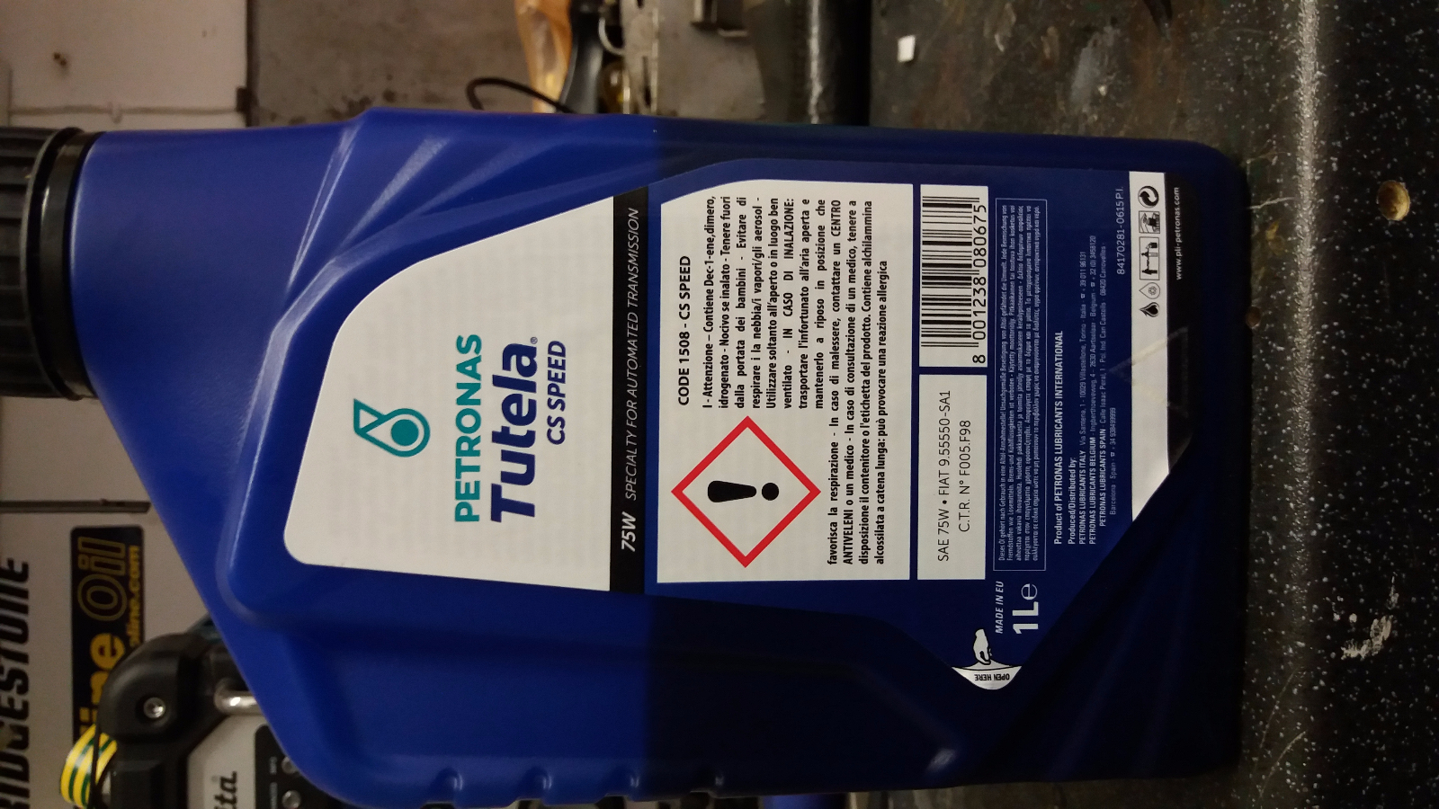

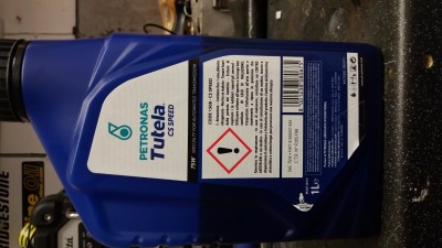

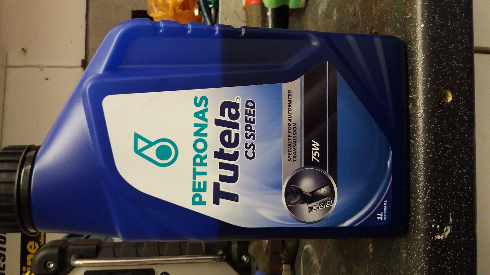

I have sent this message to the e-Bay seller.
I thought I would tell you that I used the actuator Oil I bought from you and according to Citroen Doncaster it is the wrong oil for the actuator use and I now have a £2209.55 bill for a damaged gear box all through putting the oil you sold me. This is Citroens findings not mine.
Thank You.
Yes Citroen have looked at the container and tested the oil and say that the oil is the cause of the damaged actuators. Now have to wait a week for Citroen to get the parts delivered from France.
By the way did I tell every body I still like my C5 X7.
If only I could afford a Lexia I might have been able to call their . ( Citroen) bluff.
Thank You.

I think there is a valuable lesson here for others regarding types of oils. I've put a link to the recommended oils here: There are 2 types depending on the Actuator types MCP / MTA or DCT (near the bottom of the guide):
https://www.frenchcarforum.co.uk/wiki/C ... arbox_Oils
