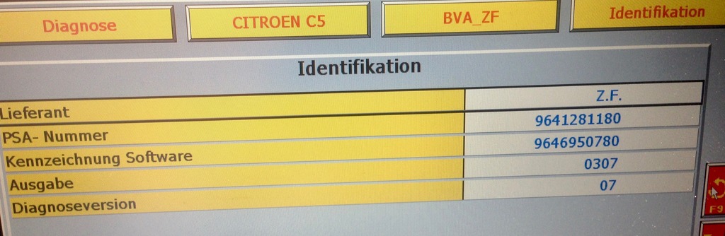

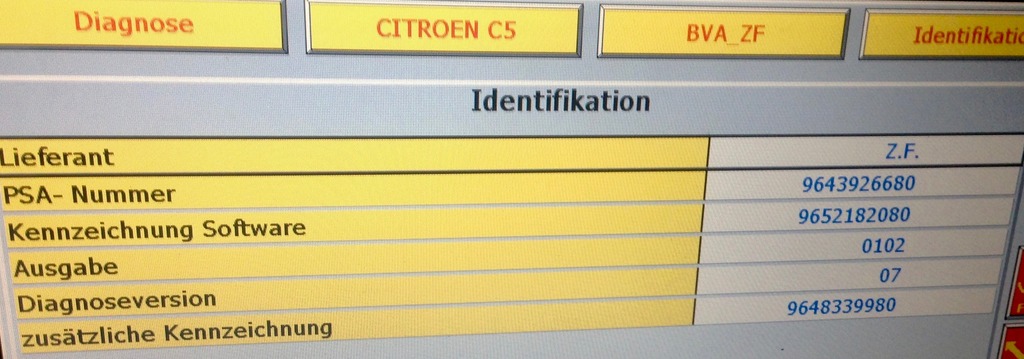

for those interested: everything is fine now! i changed the gearbox ecu ... the new one has a more recent software version.
OLD:
NEW:
