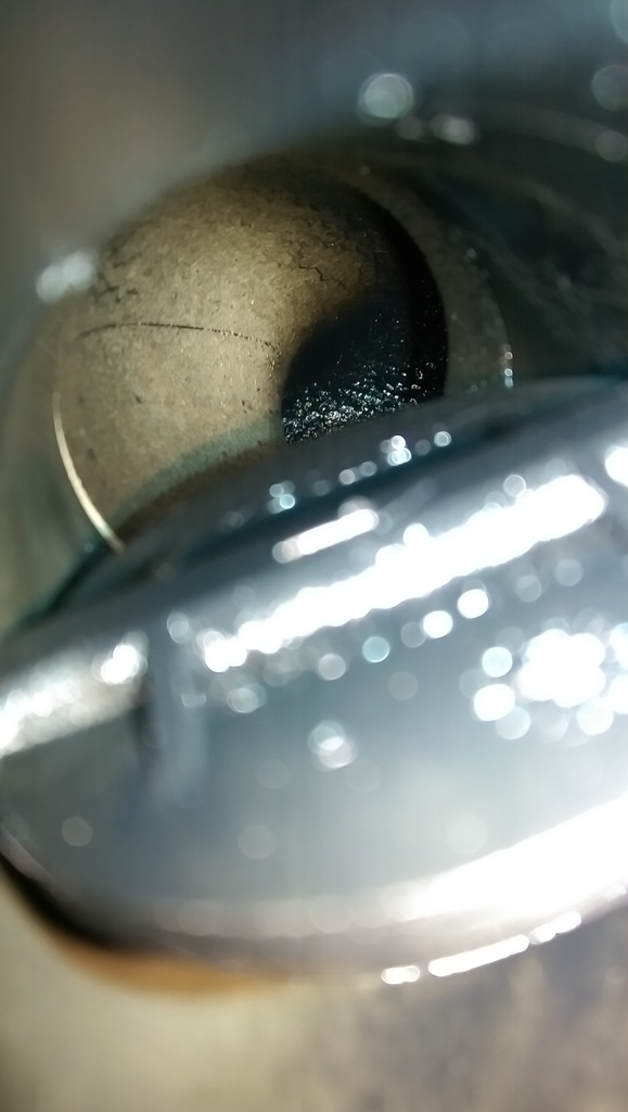

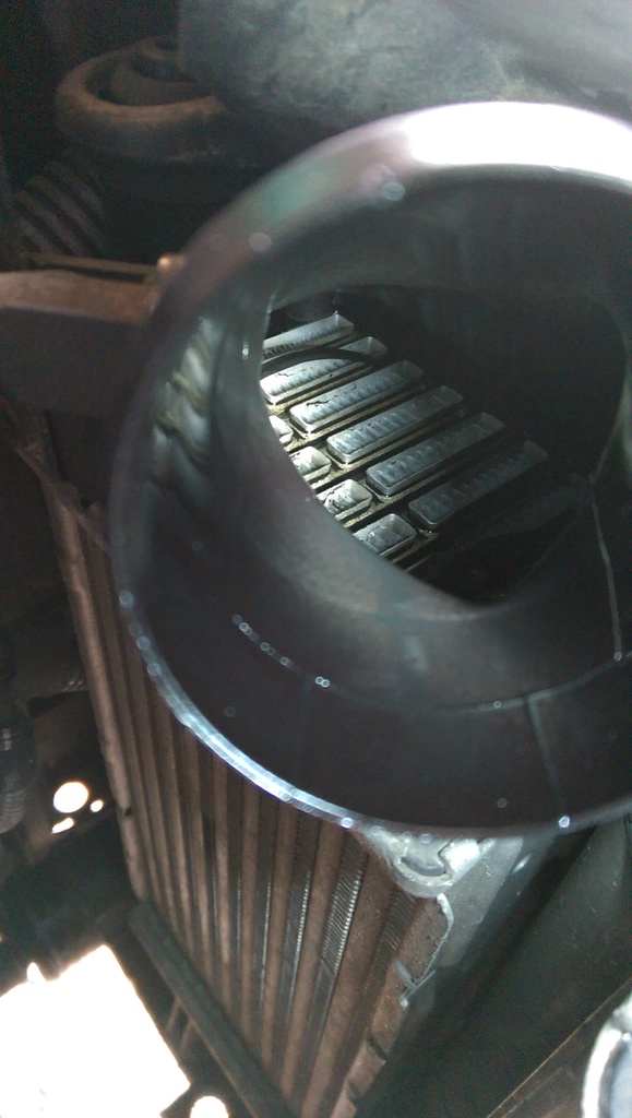

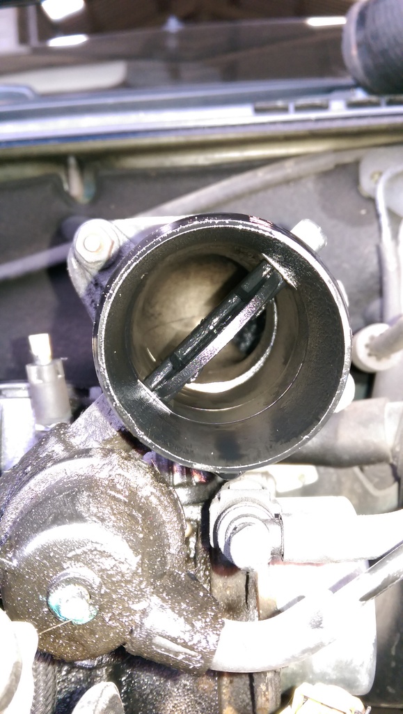

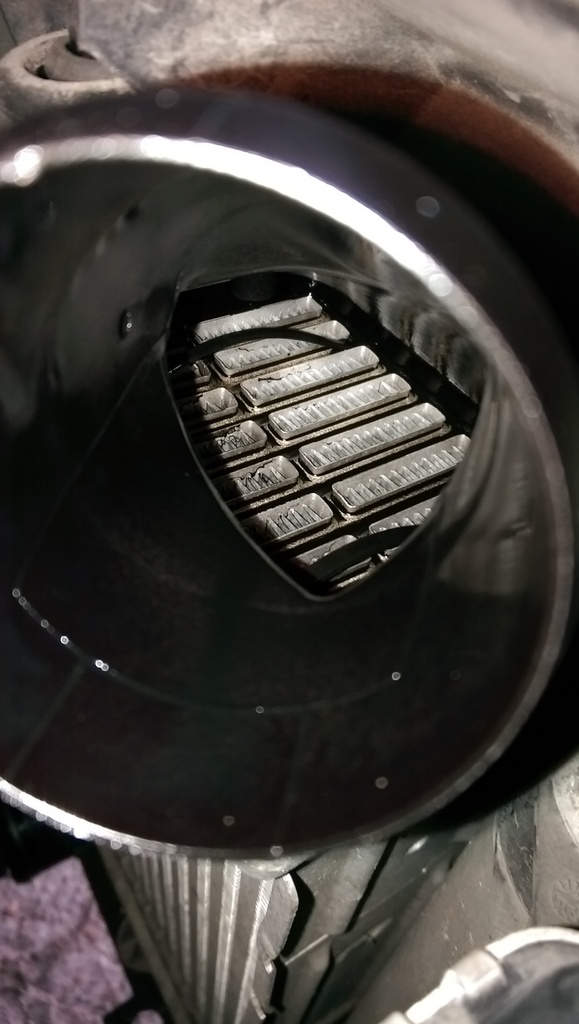

The next weekend I stripped down the inlet system from throttle body to turbo, expecting to find either split/loose joint or it full of oil/gunk. Nothing. All nice and tight and clear, except, it looks, for right inside the inlet manifold.Some pics (everyone like pics, right? :-D )
Intercooler nice and clean;
Although interesting it does seem to have a couple of loose rubber rings around the core? (can see slightly better in this photo with the focus changed);
I don't think that's anything to worry about though...
Here's the view through the throttle body;
And zoomed in at the back, you can see the gunk collection;
