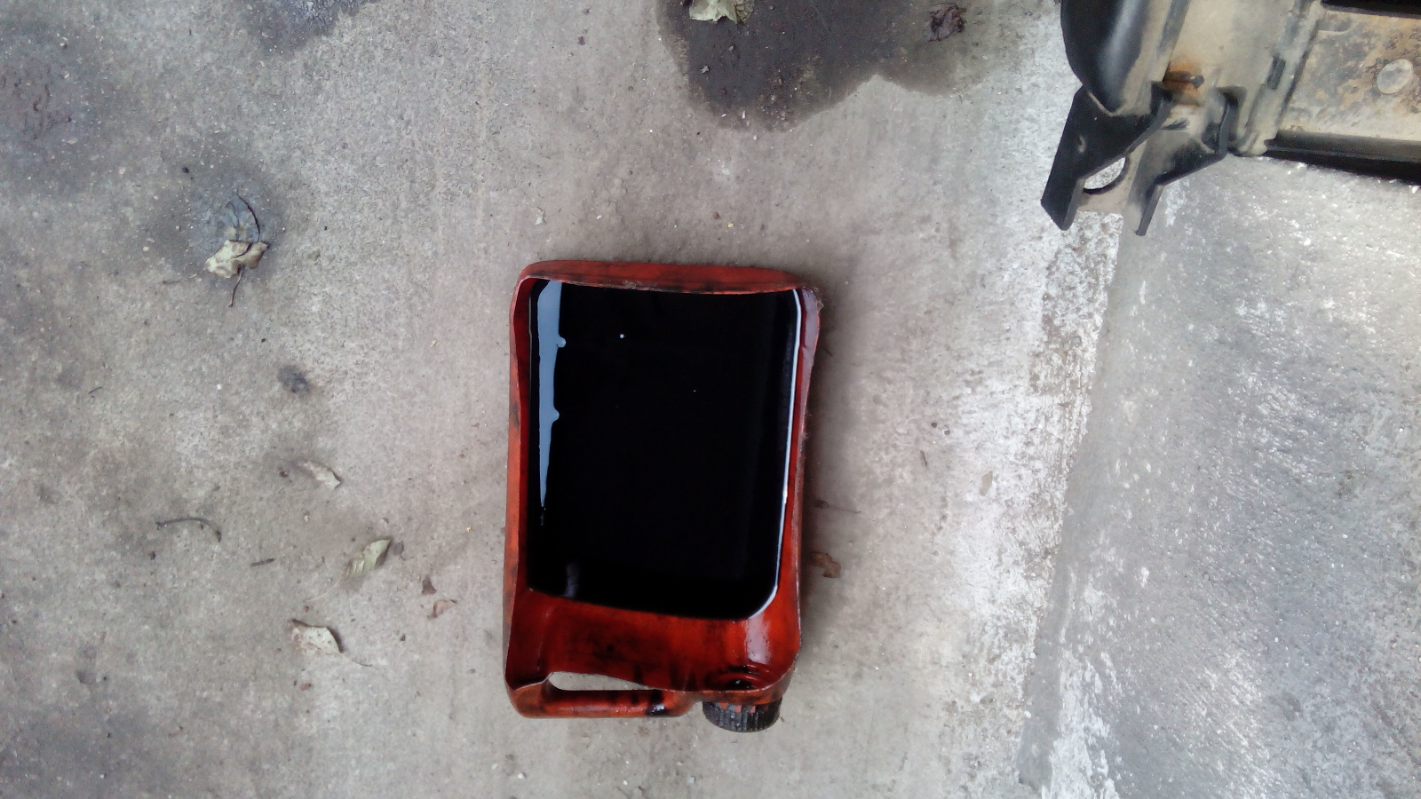

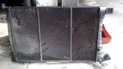

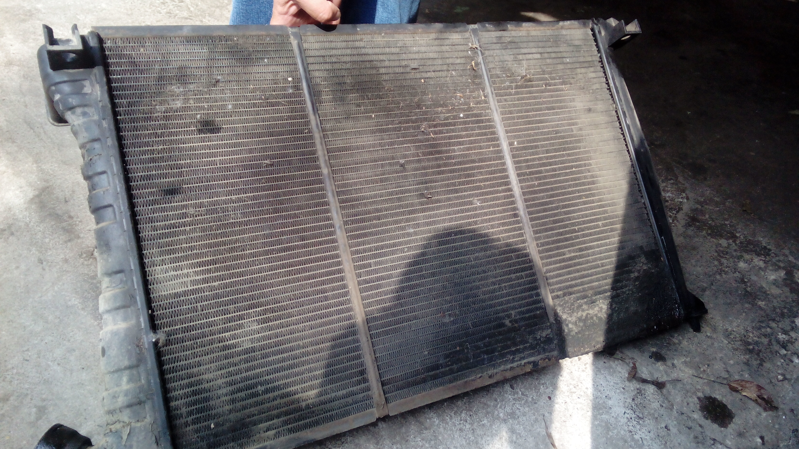

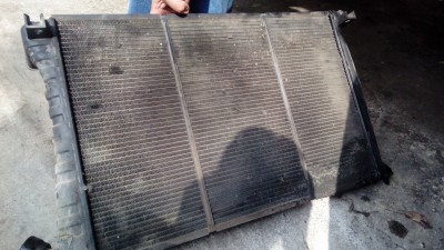

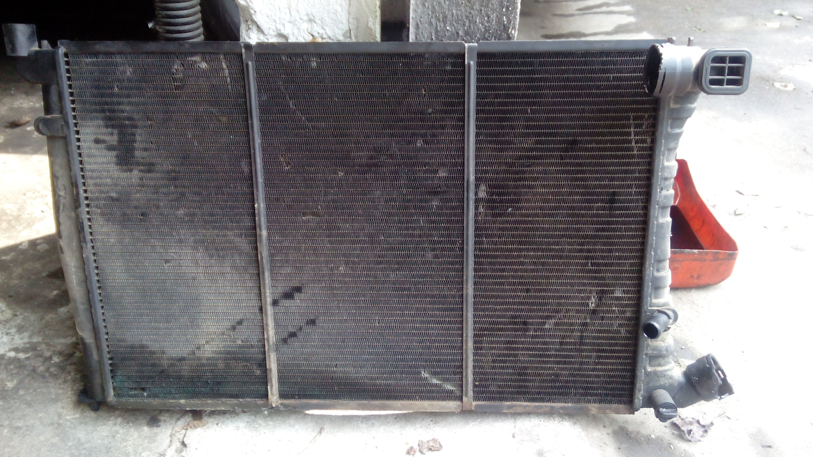

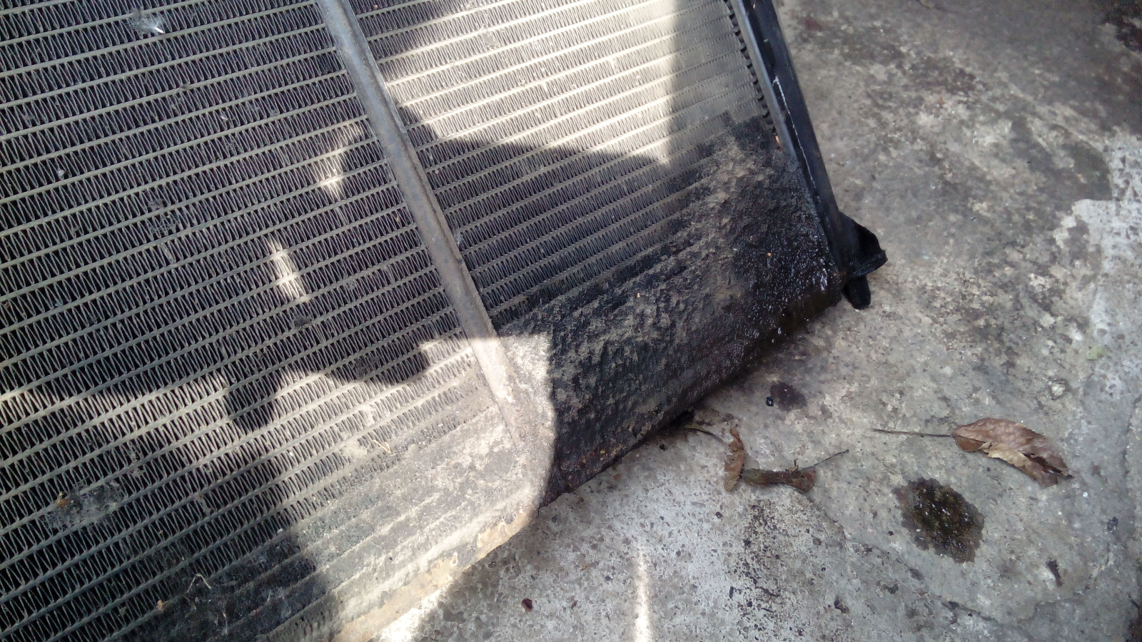

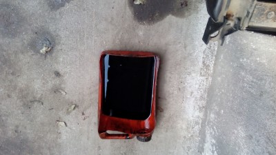

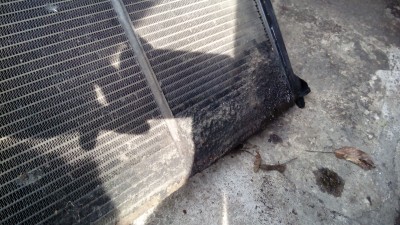

Here are some horrifying images of the old radiator. The black gold was actually my antifreeze. Have no idea what made it that way. Haven't changed the antifreeze in 6 - 7 years. Gonna keep an eye out now, hopefully won't get the same.
